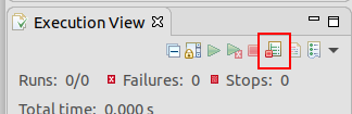

Re: RCPTT : some questions [message #1801669 is a reply to message #1799978] Thu, 24 January 2019 08:35 Go to previous message
Maria Barova wrote on Tue, 18 December 2018 05:08
However, after failure the suite just stops. I used all kinds of contexts and nothing works.
Please disable Stop on First failure mode in Execution view.
