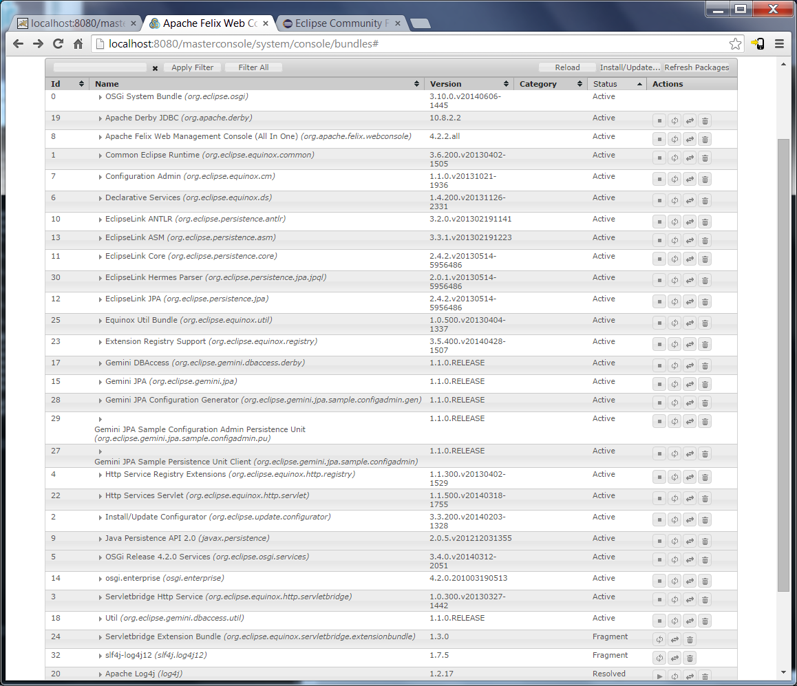

Hello there,
Can someone share a "ss" list (or screen shot) of bundles where the out-of-box Gemini JPA samples has successfully run?
I have attached mine which gives me error can not find "org.eclipse.persistence.internal.jpa.rs.metadata.model.Link".
Thanks a lot,
David
