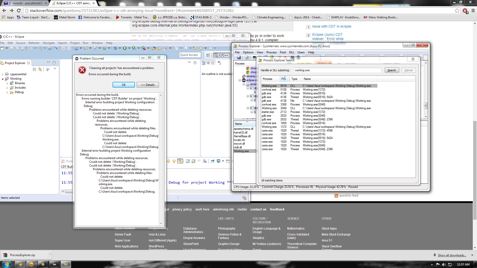

I am having this problems regarding eclipse...
I have this problem day by day and cannot figure it out...
When i clean all projects it says ... well, I will leave a photo for you to see.
This issue won't let me work in eclipse anymore...i need to restart my pc in order to work again, but this problem risees again and again ; sometimes when i clean all projects it cleans it , but the most of the time it won't do ...
I have opened process explorer thinking it my help.
Thanks !

Since your program is running the OS will not allow the deletion/clean of your executable,
So the program needs to be stopped before you clean the project.

Your program is under execution on the Windows Operating System (OS), and therefore this Windows OS does not seem to allow the removal of your exe file.
I tried on the Linux OS and this behaves different as I can remove the executable file while the program is actually running.
You can try stopping your program before cleaning the project.

As long as your application "working.exe" is running the file (and the folder containing it) cannot be deleted. You have to stop "working.exe" before cleaning your project.
