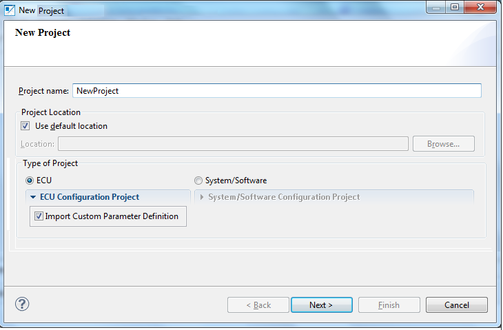

But if test is passing in my scenario, that shell will not be active/opened(Shell will close auotamatically) so in method with @after annotation if i try to write close shell code then it will throw WidgetNotFoundException.
Refer screenShot:
In this shell if i am trying to click on checkbox(Import Custom Pdf) and if that checkbox is not enable and test case will fail. Then time i need to click on Cancel button on shell. If test case is pass then no need to click on calcel button.
