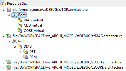

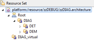

I have implemented the cross resource containment, it works.
In my new top.architecture, I add one folder (BlockX_virtual) for each linked block and use right clic to choose "Control..." and I choose the expected BlockX.architecture.
This has 2 consequences :
- In the original BlockX.architecture, it adds a node BlockX_virtual at the same level as Root.
- In my scripts, instead of parsing the top.architecture directly, I will have to load all the references.
This is completely acceptable, I don't see any limitation up to now...
Remi
> at the same level as Root. - In my scripts, instead of parsing the
Hmmm. I don't think I completely follow. What I'd expect is that you
can have some resource top.architecture that contains a root object x.
It would have proxy resolving containing references so some other
resource y.architecture could contain an object y and then x can cross
resource contain y. So each resource only has one root object. If you
load top.architecture and use something like resource.getAllContents(),
you would visit all objects, including the ones in all other resources...
> Regards,
> Remi

On 30/07/2014 10:54 AM, Remi ADAM wrote:
> Ed,
> Below is the TOP.architecture view.
> I have created one node for each controlled resouce. DIAG_virtual allows to load DIAG.architecture.
> The text view of TOP.archi looks like that:
> <?xml version="1.0" encoding="UTF-8"?>
> <architecture:Root xmi:version="2.0" xmlns:xmi="http://www.omg.org/XMI" xmlns:architecture="http://architecture/1.0" xmi:id="_gX9ugGcAEeOnxpO1IkhpXA">
> <modules href="file:/D:/WORKSPACE/ws_ARCHI_MODEL/zzDEBUG/zzDIAG.architecture#_zFWIIRcfEeSvR-VX0bDXYw"/>
> <modules href="file:/D:/WORKSPACE/ws_ARCHI_MODEL/zzDEBUG/zzCDD.architecture#_gfBpEBcmEeSvR-VX0bDXYw"/>
> <modules href="file:/D:/WORKSPACE/ws_ARCHI_MODEL/zzDEBUG/zzCORE.architecture#_jvCoUBcmEeSvR-VX0bDXYw"/>
> </architecture:Root>
> Is it ok ?
Yes, so there's a single root object and it cross-resource contains
three other objects.
> (on the DIAG view, we can see that DIAG_virtual has been automatically added in // of Root.
So you're using GMF and it's storing the diagram and the model in the
same resource. It would seem maybe better to store the diagram in a
separate resource. There's some way to configure that, but I'm not so
familiar with GMF's details.

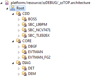

Before having the cross reference implemented, the top.archi looked like this:
<modules xmi:id="_61IaoAwkEeSEiMOfc07hWQ" shortName="CDD" longName="CDD Stack">
<moduleChildren xmi:id="_61IaoQwkEeSEiMOfc07hWQ" shortName="BOSS" longName="Bulb Optimized Smart Switch"/>
<moduleChildren xmi:id="_61JrFQwkEeSEiMOfc07hWQ" shortName="SBC" longName="SBC Driver"/>
</modules>
<modules xmi:id="_lhQX4AwlEeSEiMOfc07hWQ" shortName="CORE" longName="CORE Stack">
<moduleChildren xmi:id="_lhRAsAwlEeSEiMOfc07hWQ" shortName="EVTMAN" longName="Event Manager"/>
<moduleChildren xmi:id="_lhRmwAwlEeSEiMOfc07hWQ" shortName="EVTMAN_FG2" longName="Event Manager FG2"/>
</modules>
<modules xmi:id="_mD38wAwlEeSEiMOfc07hWQ" shortName="DIAG" longName="DIAG Stack">
<moduleChildren xmi:id="_mD38wQwlEeSEiMOfc07hWQ" shortName="DET" longName="Development Error Tracer"/>
<moduleChildren xmi:id="_mD4kCAwlEeSEiMOfc07hWQ" shortName="DEM" longName="Diagnostic Event Manager"/>
</modules>
I was able to output module list : CDD, BOSS, SBC, CORE, EVTMAN, EVTMAN_FG2, DIAG, DET, DEM by using the code:

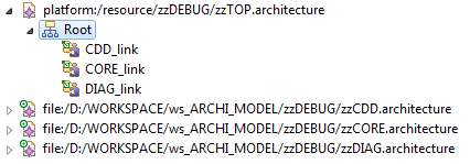

DIAG is for Diagnosys, that the name of a module container. No link with Diagram.
You are right, when I say "no module is seen", I wanted to say "none of the expected module is seen".
The output of the root.getModules() is
[architecture.impl.BswModuleImpl@18144fa (locked: false, shortName: CDD_link, longName: null, description: , createdFromGateway: false) (autosarModuleId: 0, gatewayTypes: null, gatewayTypesChangeReason: null), architecture.impl.BswModuleImpl@1ece4b (locked: false, shortName: CORE_link, longName: null, description: , createdFromGateway: false) (autosarModuleId: 0, gatewayTypes: null, gatewayTypesChangeReason: null), architecture.impl.BswModuleImpl@9ca3e0 (locked: false, shortName: DIAG_link, longName: null, description: , createdFromGateway: false) (autosarModuleId: 0, gatewayTypes: null, gatewayTypesChangeReason: null)]
But I can not parse the references linked to these fake nodes.
Remi

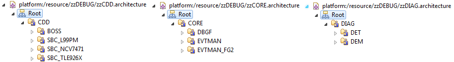

Re: [EMF] long loading time [message #1404329 is a reply to message #1404295] |
Thu, 31 July 2014 09:29   |
Remi ADAM Messages: 14 Registered: July 2014 |
Junior Member |
Hello Ed and thanks for your effort !
I'm going to try to give you the overview to understand my need.
I have 3 separated modules, based on the same ecore model.
I need to parse all these modules in a same time to be able to catch the interactions btw modules (for example sub-module DET declares a function F1, sub-module BOSS calls a F1 function, but currently not linked to DET F1). By parsing the 3 modules, I will be able to fill BOSS/F1 parameters with "declaredIn=DIAG/DET").
Up to now, the only way I found to do this was to create a TOP.archi and copy/past the modules inside:
It was functional, but I needed to copy back the updated information in the standalone module (because I want to keep this splitted modules). That's why I wanted to find a way to create a TOP.archi with link to the modules to be able to perform the same action but avoiding the copy.paste actions.
To do this I have:
- created a TOP.archi,
- added a "node" (folder of Module type : XXX_link below) for each Module,
- linked the new node by right clic "Control..." and
- chosen the right target to control.
Then a XXX_link node is created in each standalone MODULE.archi:
Thanks to this, I have a link btw my TOP.archi and my 3 modules.
Now the link is on the DIAG_link and not the Root or DIAG of DIAG.archi.
In the former TOP.archi, I was able to catch CDD, BOSS, SBC, CORE, EVTMAN, EVTMAN_FG2, DIAG, DET, DEM. With the new way, I only catch CDD_link, CORE_link and DIAG_link.
I hope it clarifies...
Is there a way to have this linked version of TOP.archi but keeping the capability to parse the standard modules?
Remi

You can only cross contain the root object of some other resource. Any
other linking you'll have to do with a non-containment reference.
