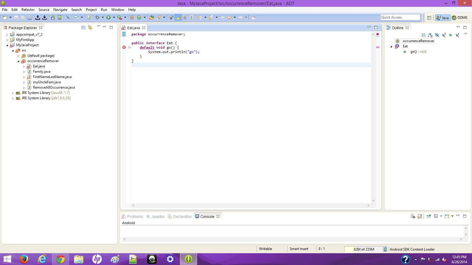

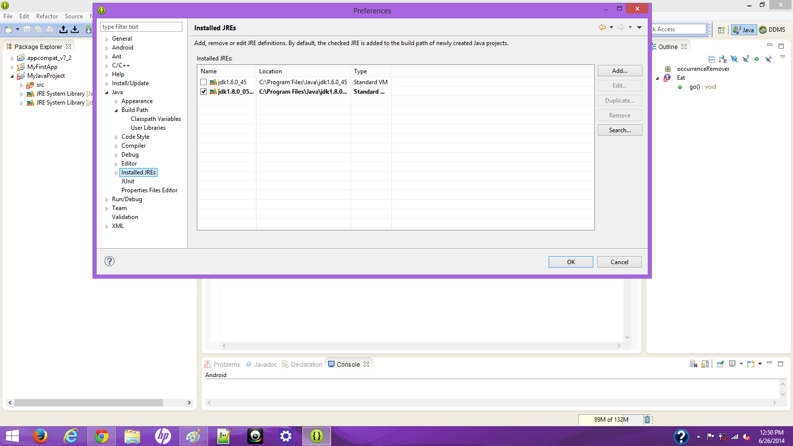

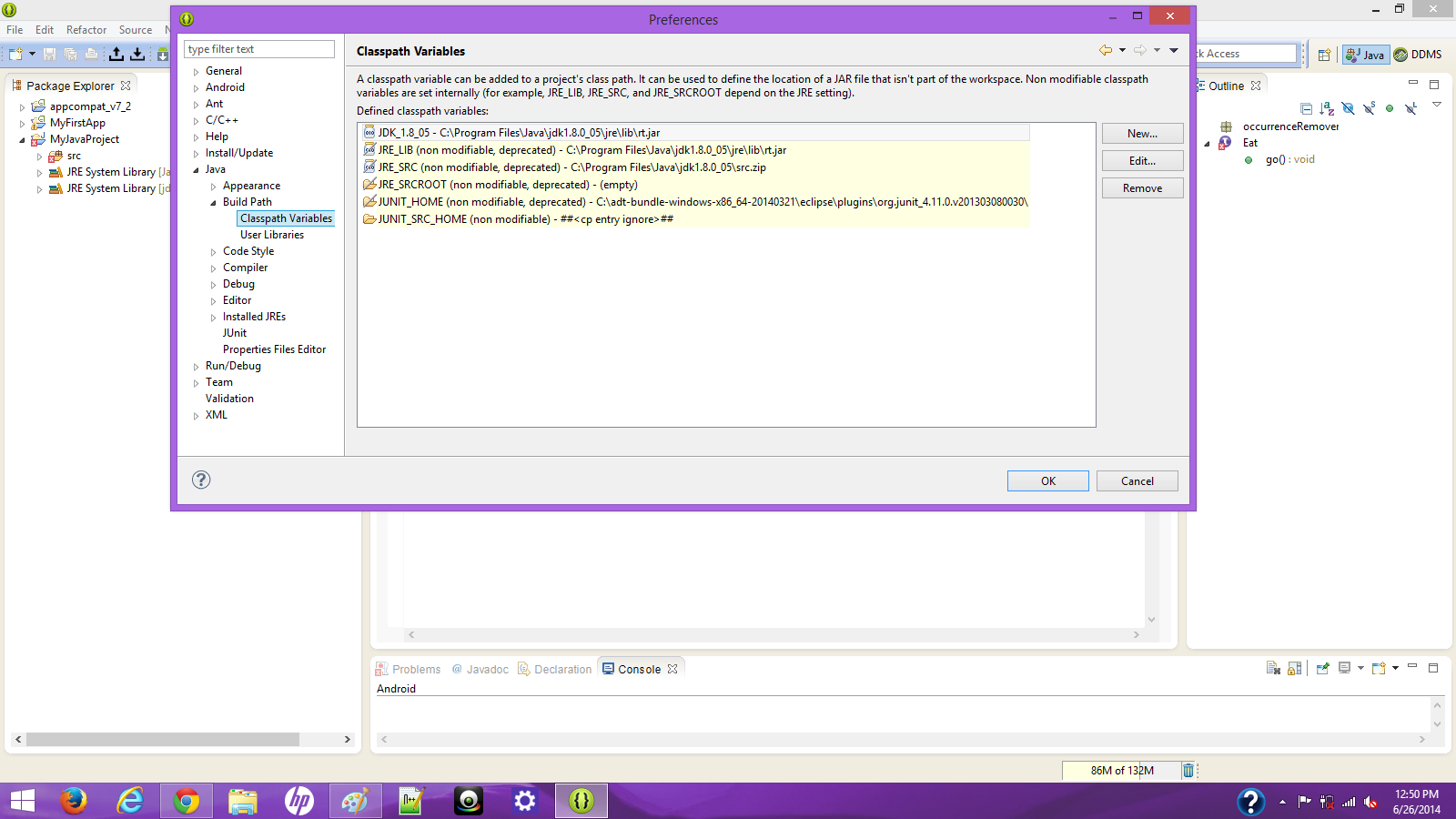

Hi guys, I desperately need help with this, I installed java 8 and set up the classpath variables and everything for jre8, but somehow I keep getting compile-time error about the "default" keyword on java default methods. I have no idea what is going on, I am an beginner, please help me guys Sad Sad Sad .
It shows the error on the "default" keyword.

JRE I have installed

the build path

You need to specify jdk compliance level. You do it either globally or at the project level.
Re: Eclipse doesn't recognize java 8 default method [message #1389534 is a reply to message #1389247] Fri, 27 June 2014 20:19 Go to previous messageGo to next message
I downloaded Eclipse Luna which has full support for Java 8, and it works beautifully, Eclipse Kepler just doesn't fully support Java 8 I think. But thank you.
Re: Eclipse doesn't recognize java 8 default method [message #1389543 is a reply to message #1389534] Fri, 27 June 2014 20:40 Go to previous message
Kepler required you to install update that added the Java 8 support.
