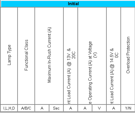

I have created a complex NatTable with 3 level column grouping, freezing, sorting, and with lot NatTable features. As part of it, I need to align the column header in Vertical manner. I created my configuration for column header layer and done with vertical alignment using VerticalTextPainter.
And here comes the issue : The Column header content for some columns are really big, say 80 characters, so we thought to go with text wrap and vertical alignment as Middle. But the content is not fitting into the column header properly though its wrapping the text. But its not alignment the text in Middle alignment(its happening with big content, incase of small content, the alignment is fine)
Say for example , if my total content is 80 characters, i am able to see only 60 characters (with text wrapping) and not able to see 1st 20 characters.
If you consider my content is :
"For Auto component the maximum output cuurent @ voltage 14.5 and 0 degree temperature"
I am able to see content that highlighted in Bold font.Not able to see 1st few characters, and the alignment goes like this for text wrapping(Texts are in vertical manner) :
index.php/fa/18006/0/
Can anyone help me on this?

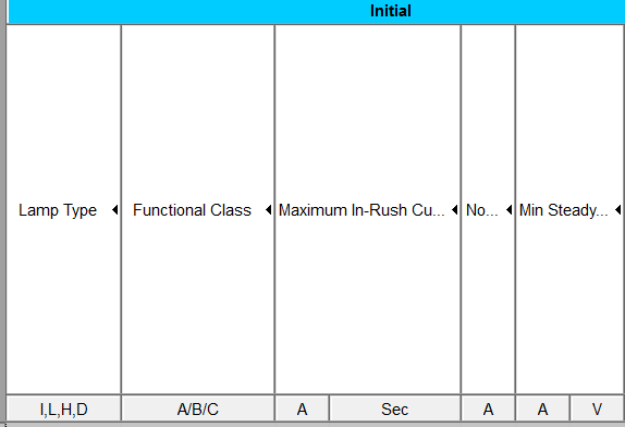

But this style is not working . The result comes like this:
index.php/fa/18009/0/
Since configuration is not able to realize the custom label added for vertical painter, the text appear in horizontal alignment.

Well, that is because there are new labels that are added on top of the label stack. And you are overriding getConfigLabelsByPosition() and adding your labels at the bottom. Try to add your labels on top.
