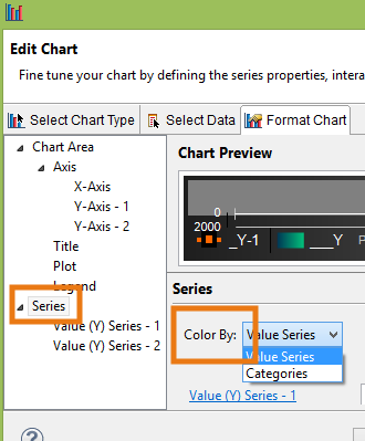

It seems your chart is setup to color items by category. There is an option which allows to color by series:
index.php/fa/17577/0/
I hope it helps

Thank you for your response. As I mentioned, I'm using the BIRT API in Eclipse (Java code) and not the BIRT report/chart tool...
Would you know what API would let me change how the series is coloured (i.e. instead of by category, use by "value series"?

SUCCESS!!!
chart.getLegend().setItemType(LegendItemType.SERIES_LITERAL);
LegendItemType controls the same setting you showed in your drop-down. The two choices are SERIES_LITERAL or CATEGORIES_LITERAL.
