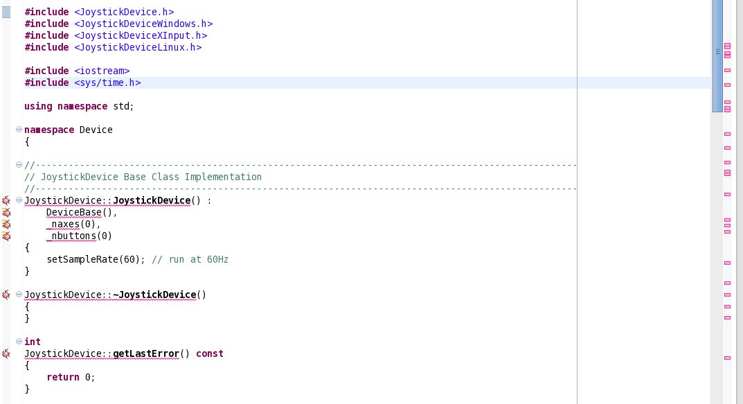

I'm using Eclipse Juno and created a project from an existing Makefile project. The source directory contains both header files and cpp files, which all show up in the Eclipse project.
However, the code analysis shows many warnings in the .cpp files about being unable to find member declarations for a classes that are defined in the local header files. The include files are found successfully.
The only wrinkle is that my companies convention is to use <..> notation for all header files. I tried changing this to "...", but it still doesn't work.
Any suggestions on what I can do?
Screenshot:
index.php/fa/17359/0/

Re: Indexer cannot find symbols in local header files [message #1263890 is a reply to message #1239906] Tue, 04 March 2014 16:29 Go to previous messageGo to next message
The indexer can find the header file just fine. If I select the header file and choose "open declaration" from the right-click menu, the header file is opened.
There are no errors markers in the header file.
When I selec one of the marked methd Eclipse says "Member declaration not found."
