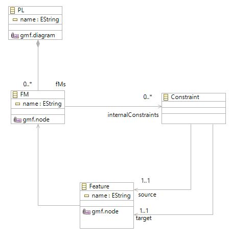

I want to create my own dialog instead the standard property descriptor. This dialog should include two buttons for adding and deleting elements. The elements are the following:
class FM{
  unsettable attr EString name = "FM";
  ref Constraint[*] internalConstraints;
class Constraint{
  unsettable attr ConstraintType constraintType;
  ref Feat[1] source;
  ref Feat[1] target;
I want to be able, to assign/delete objects of Constraints to FM during the dialog is open.
I've already created this dialog, but I've no clue how to add or delete objects to each other without breaking the emf rules.

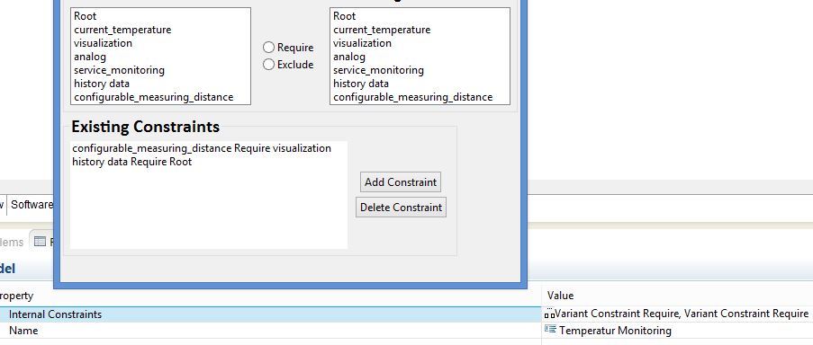

As you can see in the following images, the constraints are assigned to FM, but it doesn't seems to be persisted in the file..Can anyone help me with this?

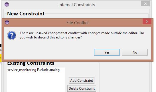

But then I get the following warning, which I don't really understand:
index.php/fa/17371/0/
When I'm adding another constraint, I get this error, which wasn't there before:

I mean the generated editor, which you seem to be using judging from the
warning you get. I think I understand your use case slightly better.
What happens is that the resource is already in use and loaded in your
..xyz editor. Then if you load the resource explicitly and save it, the
editor will detect this and show the warning.
So I think you should obtain your editing domain from the editor which
implements: IEditingDomainProvider and execute the AddCommand on the
stack of that Editingdomain. I am not very familiar with the
getEditingDomain() code in AdapterFactory, but you could debug this and
see what happens. (Is it the same editingdomain as the one used by the
editor).

That's the problem, I'm stucked with this for a while now..
Maybe you or someone else can tell me, what it mean when objects are shown inside the property window, like in the following image:
index.php/fa/17382/0/
Using then the save mechanism, I would expect that they are persisted in the file, but this is not the case..
So it seems that the reference exist inside some EMF cache, but for some reasons can't be persisted in the file.
  • Attachment: Unbenannt.JPG
    (Size: 16.78KB, Downloaded 416 times)
Re: Create own PropertyDescriptor [message #1238078 is a reply to message #1238069] Fri, 31 January 2014 05:41 Go to previous messageGo to next message
Maybe it's worth studying a bit how this works.
In a generated editor you will see this:
public IPropertySheetPage getPropertySheetPage() {
PropertySheetPage propertySheetPage =
new ExtendedPropertySheetPage(editingDomain) {
public void setSelectionToViewer(List<?> selection) {
ServicesEditor.this.setSelectionToViewer(selection);
ServicesEditor.this.setFocus();
public void setActionBars(IActionBars actionBars) {
super.setActionBars(actionBars);
getActionBarContributor().shareGlobalActions(this, actionBars);
propertySheetPage.setPropertySourceProvider(new
AdapterFactoryContentProvider(adapterFactory));
propertySheetPages.add(propertySheetPage);
return propertySheetPage;
so the propertysource is an EMF AdapterFactoryContentProvider
This can adapt an object to an IItemPropertySource for an object.
Eventually when changing a value the code in ItemProperyDescriptor is
called:
public void setPropertyValue(Object object, Object value)
this uses the EditingDomain obtained from the factory and a SetCommand
to modify the object.
they are persisted! (You get a warning the file changed). but it seems a
different *process* is writing the file, hence the warning. this is the
part I have no insight in.. perhaps you can share how the dialog saves
the code.

The warning only appeared, because I added the resource.save stuff, but this causes only problems and the regular save mechanism sufficient..So I removed it and now I don't get any warning or exceptions..
I can add properties and close the dialog..When I reopen the dialog, the properties are still there, which is what I want:
index.php/fa/17383/0/
When I close the editor then, it ask me for saving (so it recognizes that there has been changes in the model), which I answer with yes..but when I reopen the editor, the properties are not existing anymore:
index.php/fa/17384/0/
So in my eyes it seems that they are cached somewhere during runtime, but not persisted for some reasons
Re: Create own PropertyDescriptor [message #1238111 is a reply to message #1238093] Fri, 31 January 2014 07:22 Go to previous messageGo to next message
On 31-01-14 12:24, Phil H wrote:
> Thx for your help till now!
> Just to clarify:
> they are persisted! (You get a warning the file changed). but it seems a different *process* is writing the file, hence the warning. this is the part I have no insight in.. perhaps you can share how the dialog saves the code.
> What do you mean with the last sentence? What code should be saved?
and you are sure the save is succesfull? Do you see the change appear in
the resource? (If you open the file holding your model with a text
editor, would you see the XML or XMI holding with your change in it?
yes, look at the content of the file with a text editor. you can also
debug the save method of the editor.. If the Command is wrong for some
reason which would lead to an invalid model, this could break the save.

Oh, you're maybe right. It's a non-containment reference, as shown here:
class FM{
class Constraint{
  ref Feat[1] source;
  ref Feat[1] target;
But for what reason is emf generating then F_M__INTERNAL_CONSTRAINTS ? This is the only reference between this two classes..
So constraint has only the reference to FM and no containment reference..Which is then the resurce which holds my object? I already searched for examples, but couldn't find any good explanation.. In the following there is snippet from my metamodel:
index.php/fa/17409/0/
    (Size: 24.82KB, Downloaded 369 times)
[Updated on: Wed, 05 February 2014 13:07] by Moderator
Re: Create own PropertyDescriptor [message #1240348 is a reply to message #1240106] Thu, 06 February 2014 04:15 Go to previous messageGo to next message
Sorry, I am not familiar with xcore. In the Ecore you can see it in the
properties.
> class FM{
> class Constraint{
> ref Feat[1] source;
> ref Feat[1] target;
Regardless if it's contained or not contained, a feature is generated
(also in the Literal format), as you specify this in your model. So to
answer your question: Because you told EMF to do so :P
The Resource can contain *any* EObject so the definition of a specific
feature is not needed to hold objects in Resource.
Judging from the diagram, it's the other way around FM -> Contstraint.
You need to put it in the Resource opened by your editor. You can use an
ADD command for this also.
constraint = ...
myResource = ResourceSet.get(URI TO YOUR RESOURCE);
Command addToResource = new
AddCommand(editingService.getEditingDomain(),
myResource.getContents(),constraint);
a_command_stack.execute(addToResource)
have you tried this?
