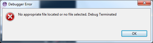

when FF or chrome trigger the breakpoint, eclipse get the focus and display the message attached as attachment.
index.php/fa/16781/0/

>No appropriate file located or no file selected. Debug Terminated
It simply means there is no corresponding file(local copy) in your workspace.
Xdebug is working fine and PDT is receiving debug-messages properly, but PDT could not find out the debugging target php file in your workspace.

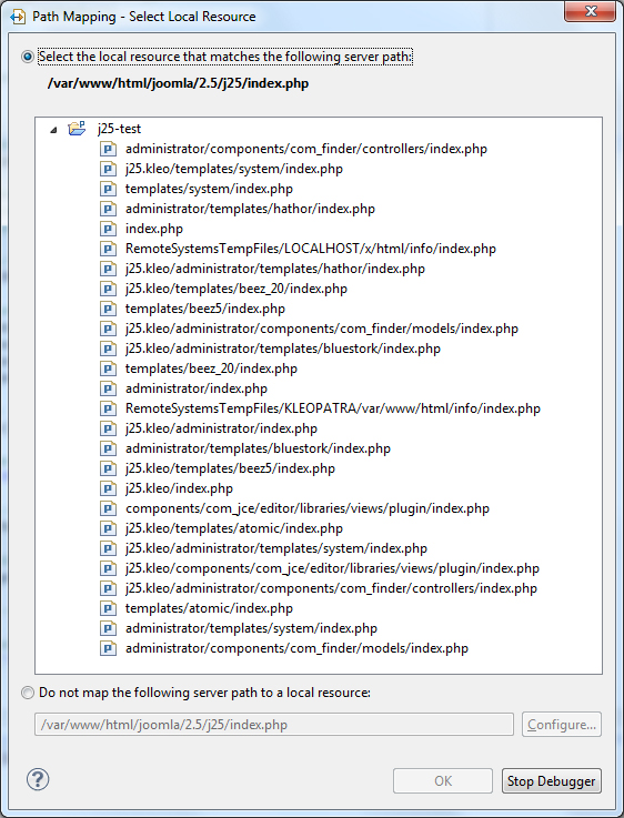

When in Chrome browser i run the xdebug plusing and load the page to debug, PDT displays the mapping window asking me to map server index.php to local index.php (see screenshot)
index.php/fa/16829/0/
even if i do it with the correct index.php on local / project side, i still do not debug the function i want to Sad
so what am i doing wrong ?

ok, now i discovered that i was wrongly mapping a file... now it works well.. gooood !!!! finally my preferred IDE can debug remotely Very Happy thx Dave.
