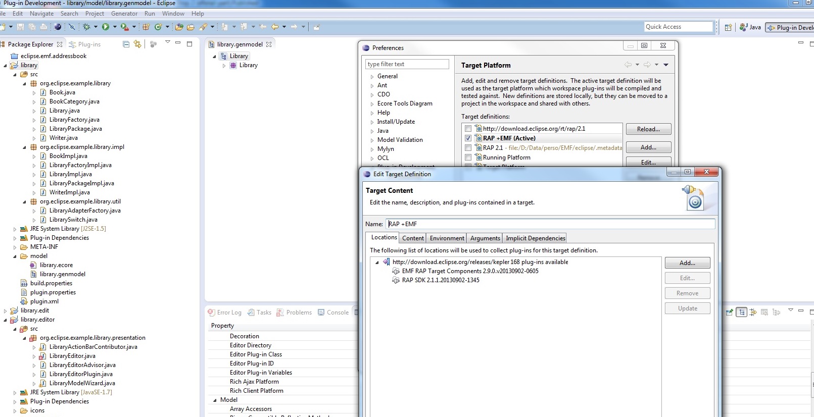

Re: EMF and RAP [message #1160678 is a reply to message #1159987] Tue, 29 October 2013 05:31 Go to previous messageGo to next message
Yes of course I generated all the classes from the "library.genmodel" file of the example.
I am using Eclipse Modeling Tools Kepler Service Release 1 (latest version on Eclipse website). May be it does not work with Kepler as the example was made with Helios.
The only difference with the tutorial is my target content which does not contains "Rich Ajax Platform (RAP) Runtime SDK 1.3" as it is not available in Kepler (http://download.eclipse.org/releases/kepler) but "RAP SDK 2.1.1"instead see file attached.
I must be missing something but I really can't find what it is...
Thanks again for your help.

Re: EMF and RAP [message #1160761 is a reply to message #1160678] Tue, 29 October 2013 06:35 Go to previous messageGo to next message
*I do not think there is any problem with the eclipse versions
*They both are same indeed. But their name and version differs.
*I see in the screenshot that, everything is fine except the "LibraryEditor.java" class. Can't you find what the problem is with this class?

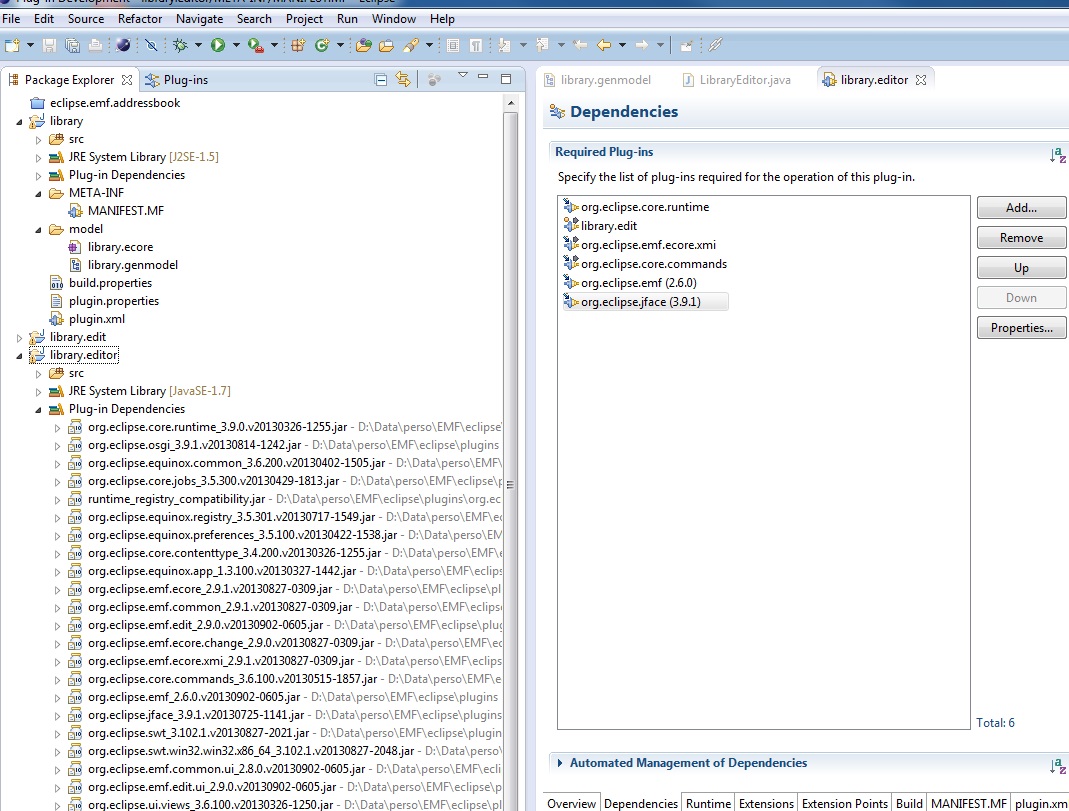

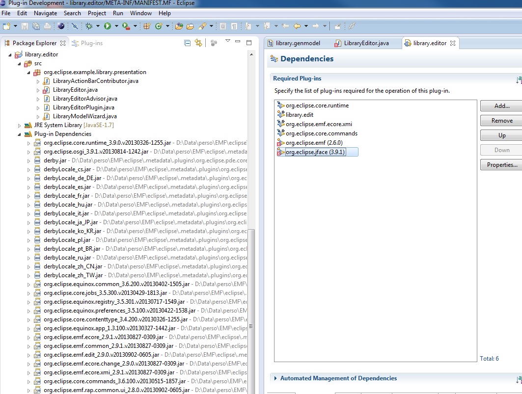

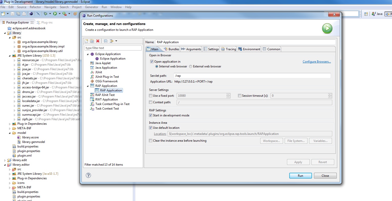

Re: EMF and RAP [message #1161076 is a reply to message #1160761] Tue, 29 October 2013 11:06 Go to previous messageGo to next message
Yes you are right the problem is that the org.eclipse.jface_3.9.1.jar is not included in the Plug-in Dependencies when I generate with the "RAP + EMF" target platform (1.jpg) while it is with the default target (2.jpg) and I can't add it manually it is not found when clicking the Add button in Dependencies.
Also when I try Run configurations I get screen in 3.jpg which is not the same as in the tutorial: "Library Application" under "Rap Application".

Re: EMF and RAP [message #1161347 is a reply to message #1161076] Tue, 29 October 2013 14:56 Go to previous messageGo to next message
Boby,
You are almost there.
Replace the dependency on "org.eclipse.jface" with "org.eclipse.rap.jface".
And try installing "EMF SDK" in your eclipse(not as target platform).
Hope this will solve your problem.

Re: EMF and RAP [message #1161529 is a reply to message #1161347] Tue, 29 October 2013 17:39 Go to previous messageGo to next message
Thanks Uma,
the error was resolved when adding "org.eclipse.rap.jface" and generating the classes again.
Also "EMF - Eclipse Modeling Framework SDK" is already installed.

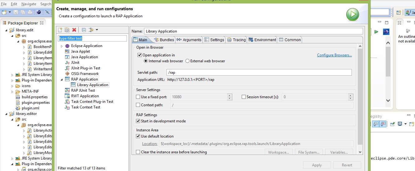

Re: EMF and RAP [message #1161857 is a reply to message #1161529] Tue, 29 October 2013 22:49 Go to previous messageGo to next message
I have the "run configurations" as attached. When trying to run I get the errors in "error.txt".
Do you have any idea how to fix this (I don't have org.eclipse.equinox.console) ?
