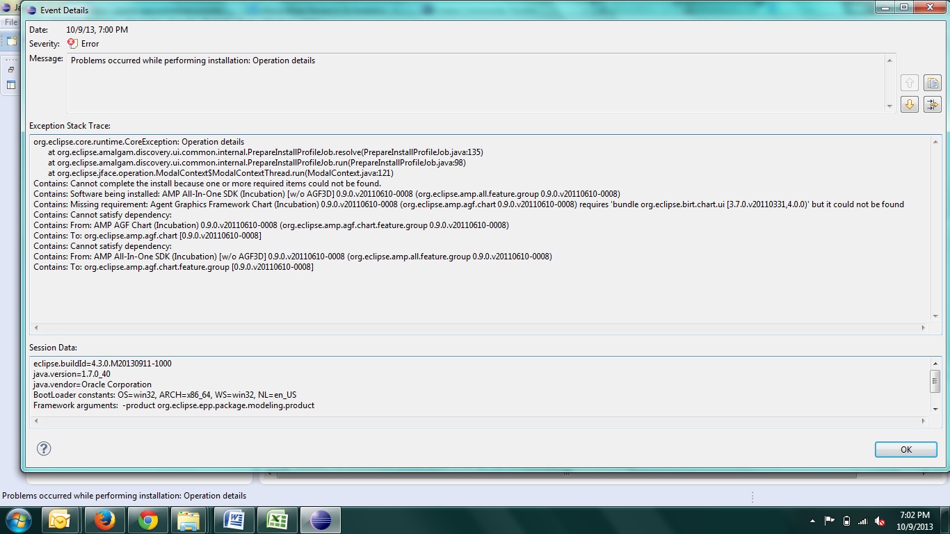

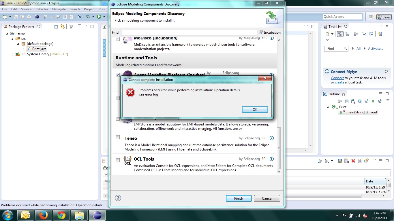

The Error log reads that the << org.eclipse.amalgam.discovery.ui >> plug in is not there.
Attached are the two screenshots.
Please Advice.
Here is the text of the error log -
org.eclipse.core.runtime.CoreException: Operation details
at org.eclipse.amalgam.discovery.ui.common.internal.PrepareInstallProfileJob.resolve(PrepareInstallProfileJob.java:135)
at org.eclipse.amalgam.discovery.ui.common.internal.PrepareInstallProfileJob.run(PrepareInstallProfileJob.java:98)
at org.eclipse.jface.operation.ModalContext$ModalContextThread.run(ModalContext.java:121)
Contains: Cannot complete the install because one or more required items could not be found.
Contains: Software being installed: AMP All-In-One SDK (Incubation) [w/o AGF3D] 0.9.0.v20110610-0008 (org.eclipse.amp.all.feature.group 0.9.0.v20110610-0008)
Contains: Missing requirement: Agent Graphics Framework Chart (Incubation) 0.9.0.v20110610-0008 (org.eclipse.amp.agf.chart 0.9.0.v20110610-0008) requires 'bundle org.eclipse.birt.chart.ui [3.7.0.v20110331,4.0.0)' but it could not be found
Contains: Cannot satisfy dependency:
Contains: From: AMP AGF Chart (Incubation) 0.9.0.v20110610-0008 (org.eclipse.amp.agf.chart.feature.group 0.9.0.v20110610-0008)
Contains: To: org.eclipse.amp.agf.chart [0.9.0.v20110610-0008]
Contains: From: AMP All-In-One SDK (Incubation) [w/o AGF3D] 0.9.0.v20110610-0008 (org.eclipse.amp.all.feature.group 0.9.0.v20110610-0008)
Contains: To: org.eclipse.amp.agf.chart.feature.group [0.9.0.v20110610-0008]

Please try installing BIRT first from the following update site:
http://download.eclipse.org/birt/update-site/3.7
BIRT has been a real trouble maker with respect to dependencies.
I'll try to take a look at this in more detail this weekend.
