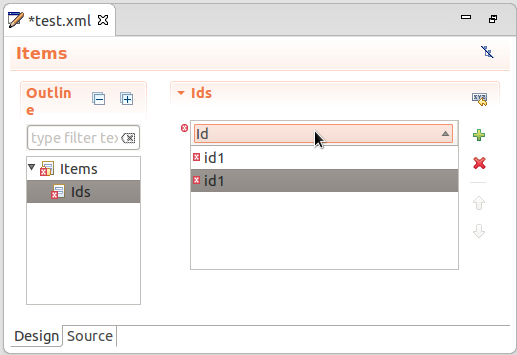

I attached my sample project as zip file and made a further screen shot showing the refreshed list after clicking the column header:
index.php/fa/15768/0/
Thank you.
Kon
Re: Trigger ValueImageService programmatically [message #1076106 is a reply to message #1075963] Tue, 30 July 2013 14:12 Go to previous messageGo to next message
This appears to be a bug in the list property editor. It provides the row-level validation marker, but doesn't actually listen for validation events. The image is only updated when the content of one of the column properties changes.
