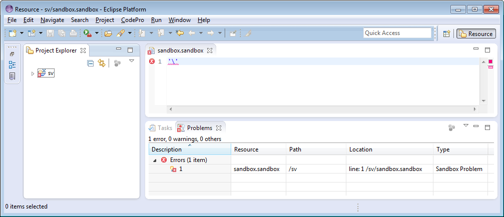

sorry for reviving this thread again - I have now tried to work with the ValueConverter - Strings containing '\_' can be parsed now - however, Strings only containing a \, i.e. '\', still do not work and won't even lead to Illegal Escape Character Issues - the parsing will just break completely and there will be lots of syntactic errors as the String can't be read correctly.
However, shouldn't defining "'\\'" in my String terminal explicity allow such a String to exist?
Model:
	assign+=STRING;
terminal STRING	:
		("\'\\\'") | ("'" ( '\\' ('b'|'t'|'n'|'f'|'r'|'u'|'"'|"'"|'\\') | !('\\'|"'") )* "'")
Entering '\' leads to an error message - the error message states "1". Which is quite confusing.

Re: Illegal escape character in json grammar for character that is in the grammar [message #1075400 is a reply to message #1075371] Mon, 29 July 2013 07:06 Go to previous message
How i solved the issue:
First I explicitly disallowed the \' escaping.
Doing that led to the "1" error message, which still strikes me as a bug.
Following that I edited my ValueConverter (convertFromJavaString) so that it doesn't enter its further conversion on reading \ if the length of the read String is 1, i.e. adding the second clause in the following code
if (aChar == '\\' && len>1)
Possibly not clean, but it seems to get the job done.
However, as mentioned, I still believe the "1" error message and the String Index out of Range message are bugs.
[Updated on: Mon, 29 July 2013 07:07] by Moderator
