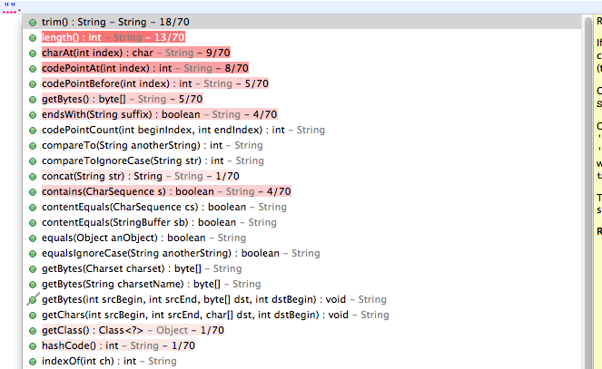

So far, we're doing this by simply appending a "m/n" String, showing how often a specific method(m) was applied out of all applied proposals(n). This works OK for a small number of proposals, but looks silly for larger values. e.g. "".substring() 2223/39643.
My idea is to use a color coded heatmap instead, where the color suggests how important a proposal is.

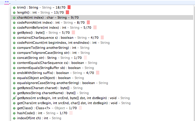

Two approaches here: 1) color the background of the entire proposal. 2) append a colored box to the proposal.
Here are two screenshots:
Keep in mind, the color scheme is just temporary.
I see some cons for both:
Option 1:
- The background color only applies to the String not to the entire line. Looks strange.
- Harder to read (can be improved with a better color scheme)
index.php/fa/15331/0/
Option 2:
- The color information gets lost, if the completion popup window is smaller than the proposal. User has to scroll to see it.
index.php/fa/15330/0/
What do you like better? Any ideas how to improve these approaches? Do you have a different idea?

I think you mixed up the screenshots. Description 2 seems to belong to the upper image.
In a first reaction, I prefer the solution from the second screen shot in which the colour information is placed next to the numbers.
Another option could be to use the colour as a background for the XXX/YYY numbers instead of using it for the entire string.
Just my two cents.

I also prefer the second solution (screenshot option 2).
I also like the suggestion from Uwe: use the colour as background for n/m.
Maybe another option would be to use bold font instead of colours?

Option 1:
IMHO, the Mylyn project has found a nice solution to this problem, using font weight and gray-scale text to convey relevance. (Also, many Eclipse users are already familiar with it.)
Granted, the original Mylyn scheme doesn't give you 256 different shades, but you don't want to distinguish that many levels anyway. (I mean, who really wants 50 Shades of Grey, let alone 256? Wink)
