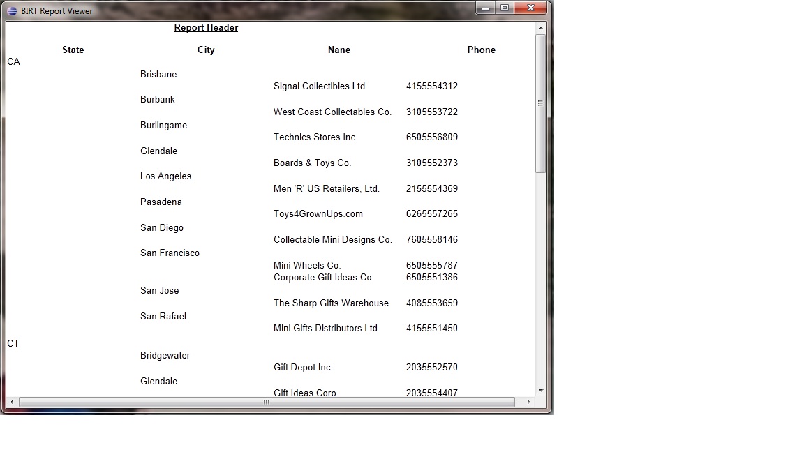

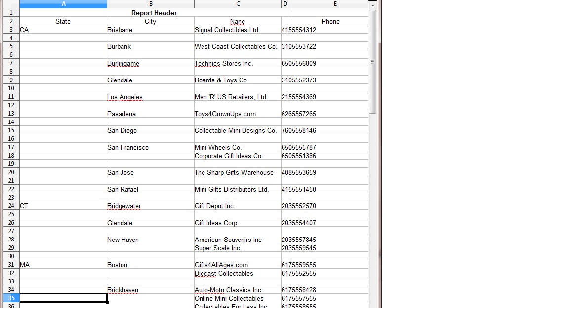

I'm new to BIRT and just started the tutorial this morning. I noticed that when the data breaks from a group, like state to state or city to city within a state, the group value gets displayed on it's own line and then the details are displayed on the next line. Is there any way for the group value/data to be displayed on the same line as the detail data?
I've attached a picture of what the report is doing and a picture of what I would like it to look like after reformatting the data in a spreadsheet.

Yes this issue is about formatting a report. The bottom line is can I suppress printing a newline character when a new group value is displayed/printed? The format I want is shown in the second image of my original post.
