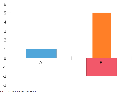

Sorry, I said columns when I meant series. There will always be three series. One of the series will always have a negative bar, one will always have a positive bar, and one can be either positive or negative. There may be more than one entry in the chart however, so the total number of columns does vary.
I have attached an example of my situation. Currently, I am using stacked bars. What I want is to make the red bar thinner, so that whichever bar ends up behind it can be seen. The number of rows in the data set will vary.

I don't think that changing the series spacing alone can resolve this issue. I have attached an ms-painted demo of what I am trying to create. I need to both change the width of a bar, and cause one bar to occlude one another.
John

Take a look at this modification of your report. The formula to figure the offset might need to be tweaked a little, if you add a title, specifically the -10 portion. This accounts for the dead space at the top of the chart which would be increased with a title. This was just a first shot at a formula to figure the offset needed, but it should be a start. I'll let you know if I find a better way.
I unstacked the second series and then moved it down half the offset and the stacked bars up half the offset, to meet in the middle. I added a parameter to the report to determine the number of rows in the dataSet, so that different variations could be tested. This appears to work pretty well for any value.
