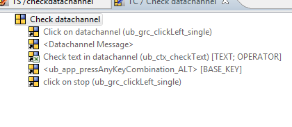

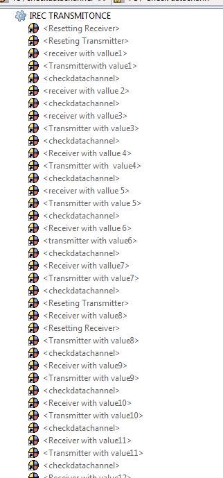

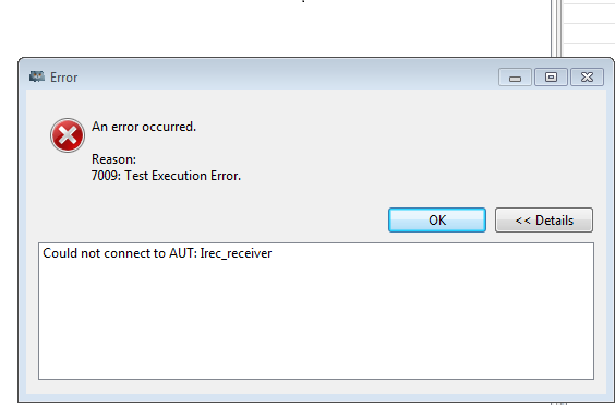

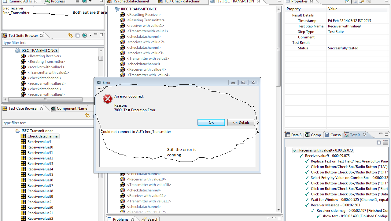

i m running with windows7 64 bit and my processor is pentium 4>again and agian i m runing to the same problem in jubula that it couldnot connect to aut.In windows 7 the problem is coming frequently but in windows xp it is rare but in windows xp after some test it is waiting infinite time to check the text .The same check text is working fine with other test cases.Supoose i have 10 test cases than after 5 to 6 test cases may wait for infinite time to check the text or may not.i have pasted some image of test cases and the pic of the error while it is stopped working with windows7(Couldnot connect to aut)The aut are still there.I have seen in the list.
As per your blog i am using alt+shift+TAB for switching between 2 application .And it is working fine with test cases but in the mid of test suite it is failing like this

Rajesh, it sounds like you are trying to describe two problems at once.
1. When executing a test job, sometimes the connection to the AUT cannot be made.
2. You are experiencing problems with timeouts for some checks (I believe there is another forum thread open for this).
Are they two separate problems or do they happen at the same time? If they do happen at the same time, then add the test result reports. If the first problem is separate from the second, then can you ensure that you are trying to connect to the correct AUT ID (specified in the Test Suite in the Test Job). Also here, please add (as specified already above) any log files and test result reports.
