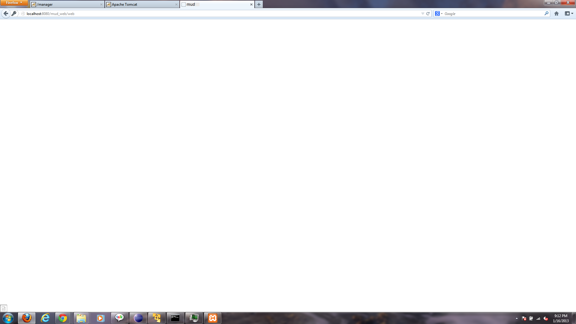

I am facing some problem after deployment of war files in tomcat. I have disabled Anonymous security filter and enabled the Basic Security Filter as given in Scout Tutorials. After deployment of war files in tomcat, rap-client service is providing me a dialogbox to enter username and password as expected. Later when I enter right credentials the page doesn't get loaded. I have attached a screenshot with this post, as you can see in screenshot there is some cracked box appears in the left bottom corner of browser after giving right credentials. But with Anonymous filter enabled and basic filter disabled, it works fine on tomcat. Even it works fine with Jetty using both Anonymous and Basic Security filter enabled. Can you please give me some pointer regarding this problem I am getting with Tomcat.

I used to have a similar problem. The thing was the user authenticated didn´t have access to the files needed. When you log on the first page (if you search the code of the page in the screenshot you will see it) it tries to read some files, and the server denies access to those files. I will search for the fix later and post it if you want...

The problem is not files or database your application is accessing, the server is denying access to javascript resources needed to "build" the GUI. I think the files are:
src="rwt-resources/rap-client-6e796d85.js
src="rwt-resources/rap-org.eclipse.swt.theme.Fallback-361cffdf.js
src="rwt-resources/rap-org.eclipse.swt.theme.Custom_7c64962d-686a85bc.js
src="rwt-resources/resources-dddebbdc.js
maybe others too.
See this post,
http://www.eclipse.org/forums/index.php/t/441354/
the problem is in the configuration of the security filter in the RAP Layer. I don't remember exactly what i changed, if you can paste here the configuration for your filters maybe i can remember what that was.

Sorry i thought plugin.xml had the fix but i can´t see any difference with yours..... i'll try to remember what was it. If you read the other post you can see that i got the tip from reading the chrome debug console (in developer tools). There i saw the error that the page was trying to load those files but the web server (tomcat) was denying access (the files existed). Somehow i managed to give the connected user access to those files, but right now i can´t remember how. Maybe someone else can give us some tip.
