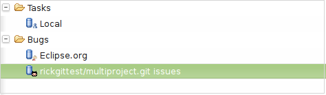

- The task repository was created, as shown here:
index.php/fa/12610/0/
Note the decorator icon used by Eclipse on the repository (I don't know what it means).
