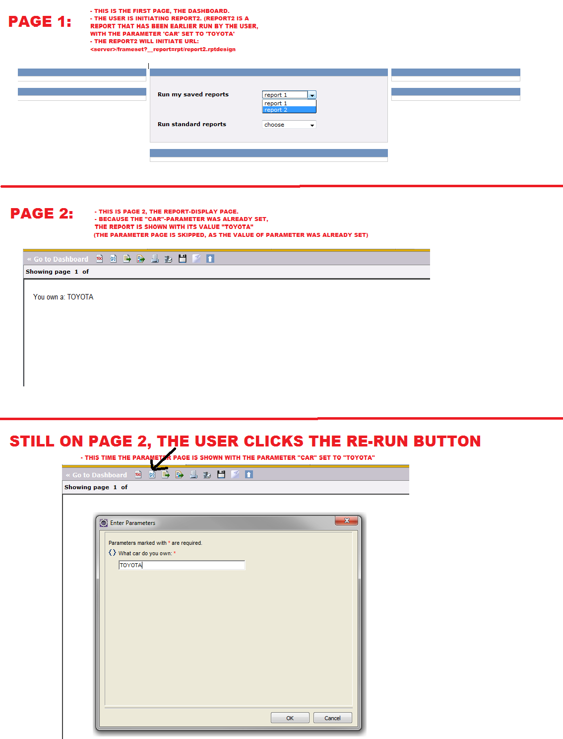

Im no good in explaining Razz so i have attached screenshots from my application with the sequence of what i am looking to do. Please have a look, it will explain what i am looking for.
if i run the report with <server>/frameset?=report=rpt/report2.design?car=TOYOTA all the functionality in the attached screenshot works.
But i as earlier explained, i want to avoid setting the values in the url, thats the reason i wanted to find a way to set/override the parameter values in birt.
Thanks for looking at my problem.

Re: Birt report viewer source: where are GET report parameters set/initialized in source code ? [message #989826 is a reply to message #989672] Sat, 08 December 2012 04:16 Go to previous messageGo to next message
Michael Williams is currently offline Michael WilliamsFriend
Messages: 1925
Registered: July 2009
Senior Member
Ok, so if the user has already ran the report, you'd like it to just load the report with the value chosen, but still allow them to open the parameter page and change the parameter? Am I getting it, now? Smile
Michael
Developer Evangelist, Silanis
Re: Birt report viewer source: where are GET report parameters set/initialized in source code ? [message #989839 is a reply to message #989826] Sat, 08 December 2012 09:27 Go to previous messageGo to next message
nari noori is currently offline nari nooriFriend
Messages: 33
Registered: November 2012
Member
Yes michael thats right
