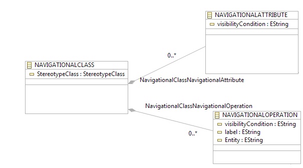

Hi , first I attached a picture of my metamodel to explain what I need help with
From the picture you can see that a navigational class has attributes and operations.So I don't know how to make or the syntax to create a constraint that checks all the navigational attributes associated with a specific navigational class. Like check for each navigational class all of navigational attributes associated with it.
Thanks in advance for your help
pd: sorry for my English, not my native language Razz

Would the following work?
context NAVIGATIONALATTRIBUTE {
constraint SomeConstraint {
check: ...

not really,I want to do something like this (i know the sintax and the code its not right)
context NAVIGATIONALCLASS {
check: self.name = "something" and self.NavigationalClassNavigationalAttribute.name="anotherthing";
Something like that so i can check all the navigational attributes associated with a navigational class in specific and check the value name in both the class and the attribute.
I hope that clarifies what i'm trying to do
thx for the help

If you need to check only the attributes of a specific class (X) you could use a guard to specify this e.g.
guard: self.eContainer()./*this navigates to the container NAVIGATIONALCLASS*/.name = "X"

I think thats it , i will try it later since i cant at the moment and will comment back.
Thx alot for all the help
Re: [EVL] How to acces a element in my model [message #989594 is a reply to message #989357] Thu, 06 December 2012 17:11 Go to previous messageGo to next message
it worked perfect
I got a last question, its there a place where i can check all the things i can use with evl like the .eContainer()? , because i never knew that existed.
Thx alot again
