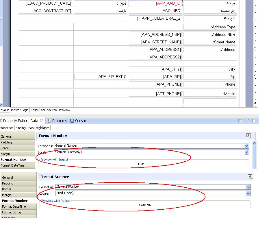

I have attached here a screenshot for German I also tried the Hindi.
index.php/fa/11660/0/
  • Attachment: arabic2.JPG
    (Size: 113.75KB, Downloaded 2206 times)
Re: Arabic [message #929610 is a reply to message #926971] Mon, 01 October 2012 11:58 Go to previous messageGo to next message
Those look correct. Am I missing something?
Jason
