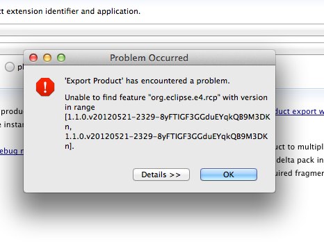

I'm trying to export my 3.x RCP application that is now running under 4.2 with the compatibility layer but I stumbled upon an issue that I can't resolve.. when exporting through the wizard I get the error:
Unable to find feature "org.eclipse.e4.rcp" with version in range [1.1.0.v20120521-2329-8yFTIGF3GGduEYqkQB9M3DKn,1.1.0.v20120521-2329-8yFTIGF3GGduEYqkQB9M3DKn].
You can see it in the attachment.

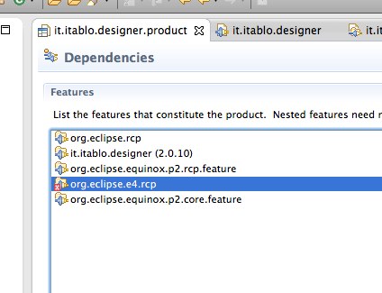

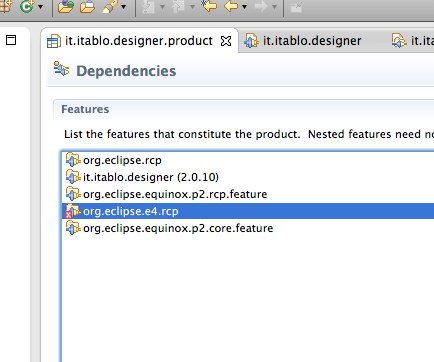

For some reason, when I click on the Required.. button on the dependencies tab, the org.eclipse.e4.rcp seems like broken.

Re: Export wizard failing [message #899900 is a reply to message #899872] Thu, 02 August 2012 14:14 Go to previous messageGo to next message
What happens when you remove it from the dependencies and then re-add it?
Re: Export wizard failing [message #899904 is a reply to message #899900] Thu, 02 August 2012 14:34 Go to previous messageGo to next message
I tried and it has the same behavior. Same error and same red cross on o.e.e4.rcp
