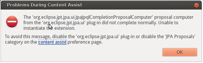

Hi everyone, recently I got a problem as you can see from the title. Hope you can give me some tips (solutions better). Thanks a lot.

After installed the Hibernate-Tools, whenever I use content assist, Eclipse shows the dialog below:

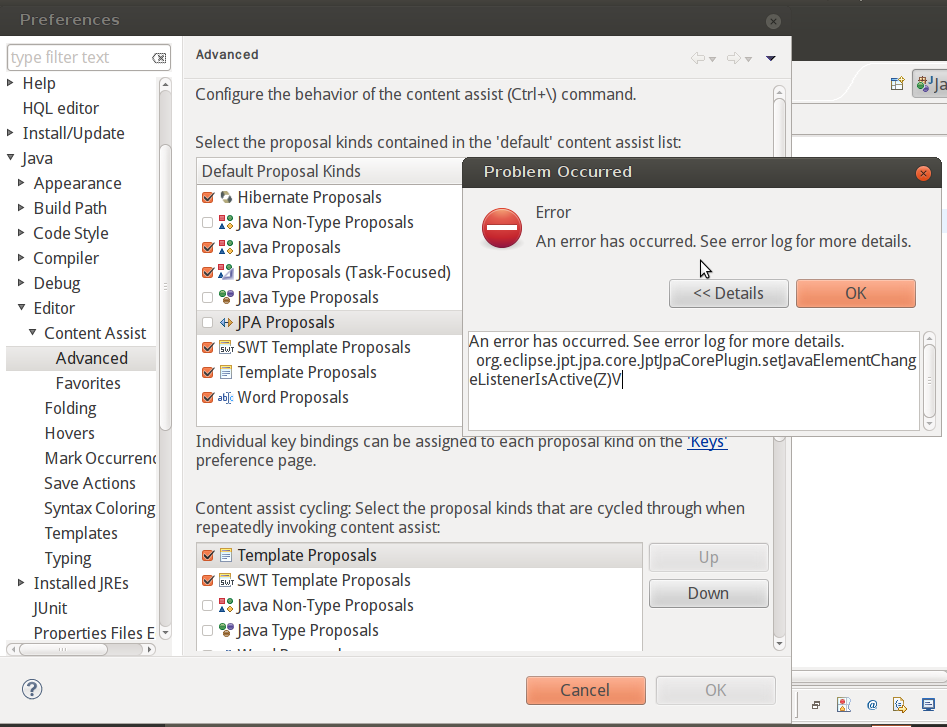

Moreover, when I do something relation to dialog, Eclipse also shows the dialog like this:

!ENTRY org.eclipse.jdt.ui 4 0 2012-07-24 14:39:59.234
!MESSAGE The 'org.eclipse.jpt.jpa.ui.JpaJpqlCompletionProposalComputer' proposal computer from the 'org.eclipse.jpt.jpa.ui' plug-in did not complete normally. Unable to instantiate the extension.

What is the full path to your workspace?
I'm not a hibernate tools expert, but I know if there is any whitespace at all the tooling is unstable.
JD
Re: Content assist goes wrong after installed Hibernate-tools [message #897698 is a reply to message #897548] Wed, 25 July 2012 02:54 Go to previous messageGo to next message
There's no whitespace in every pathes, including Eclipse, and its meta data, JDK and so on. Thanks for your reply.
Re: Content assist goes wrong after installed Hibernate-tools [message #898803 is a reply to message #897495] Fri, 27 July 2012 12:51 Go to previous message
Problem is fixed now.
