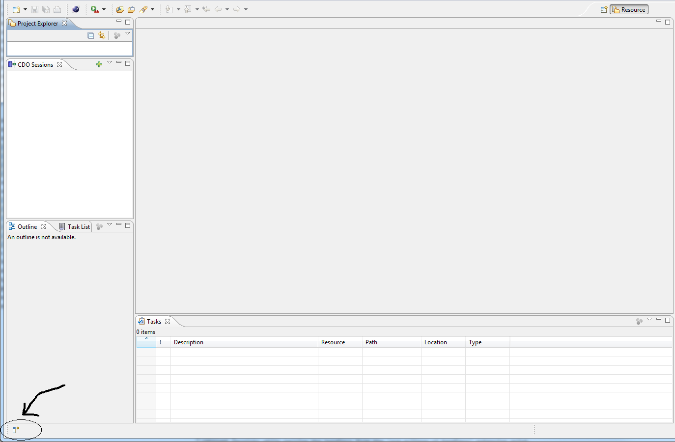

Re: How to remove fast view option in my plugin ? [message #895276 is a reply to message #894117] Thu, 12 July 2012 10:47 Go to previous messageGo to next message
becks m is currently offline becks mFriend
Messages: 59
Registered: June 2012
I've attached the image as the forum doesn't allow me to post links now.
I want not to show this icon or this bar in the image when I open my perpective.
but show it in other perspectives

Re: How to remove fast view option in my plugin ? [message #895282 is a reply to message #895276] Thu, 12 July 2012 11:29 Go to previous messageGo to next message
Paul Webster is currently offline Paul WebsterFriend
Messages: 6859
Location: Ottawa
After you make your change for your RCP app, be sure to clear your workspace or reset your perspective.

Re: How to remove fast view option in my plugin ? [message #895365 is a reply to message #895305] Thu, 12 July 2012 15:06 Go to previous messageGo to next message
Messages: 6859
Location: Ottawa
You would only need a reset if you've ever opened the perspective once without running through that configurer code. Generally, though, you would do that in your WorkbenchWindowAdvisor constructor, no?

Re: How to remove fast view option in my plugin ? [message #895388 is a reply to message #895365] Thu, 12 July 2012 16:33 Go to previous messageGo to next message
Achim E. is currently offline Achim E.Friend
Messages: 8
Location: Germany
During startup the FastViewBar.restoreState(...) method is called, to restore the workbench state from last application run.
This state is stored in your .metadata directory in a file called workbench.xml under folder .plugins\org.eclipse.ui.workbench.
This file will be written, when you've called the method setSaveAndRestore(true) from the workbench configurer.
I assume, you've done this the first time, when you're RCP application is running with the missing statement configurer.setShowFastViewBars(false).
So, if you don't follow the advice of Paul, the workbench state will always be restored from last run, which means your FastView is always visible.
