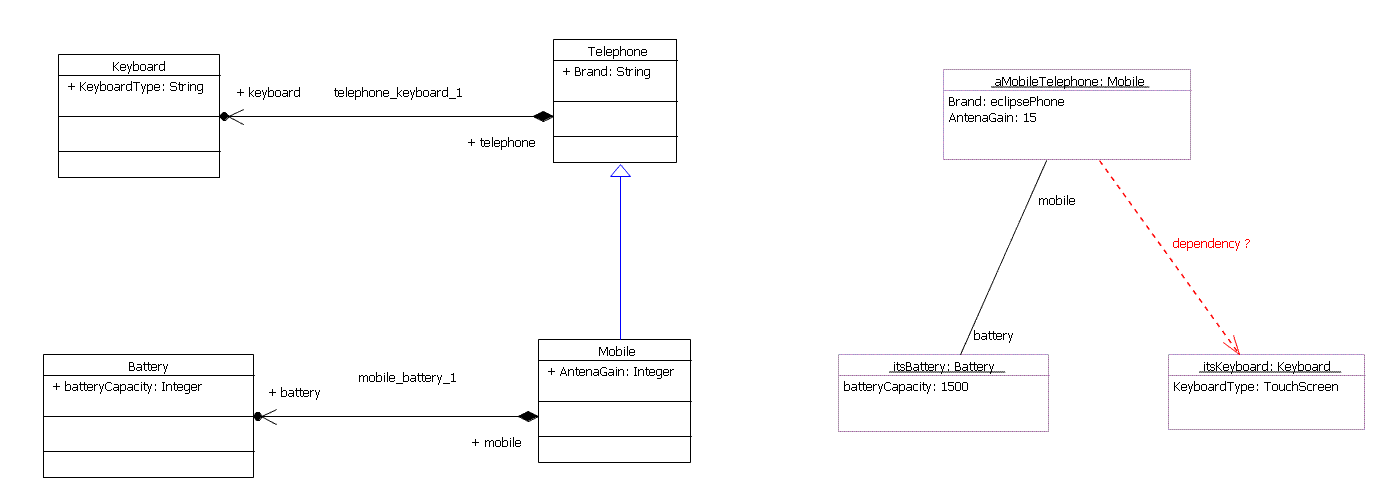

I created the following Class Diagram:
index.php/fa/10311/0/
It has on the left chain, A superclass named Telephone with composite Keyboard.
And mobile class with composite class Battery.
The mobile class is a Telephone, that's why the blue generalization is drawn.
The right side I left for the definition of the instances.
I want now to define one instance of the class Mobile.
To do so, I have also to define its composite instances.
Specifying the Battery composite instance was straight forward, connected by an instance specification link to its parent instance aMobileTelephone.
For the Keyboard instance, I wasn't able to connect it using an instance specification link to its parent instance aMobileTelephone.
Instead, just to represent my intention, I've drawn a dependency link in red.

Hello Daniel,
This sounds like a bug in the Class Diagram. The workaround is to add all inherited Classifiers to your Instance specification (i.e. add Classifier "Telephone" to the list of classifiers of aMobileTelephone).
I filled Bug 382954 for this issue.

I agree with you, many thanks for your help.
For ease of understanding I'll link the reported bug to this topic.

As the Bug 382954 was solved and the contribution was merged to the Eclipse Luna, I'm proud to say I've tested it and it's now working the way it should be! Thank you all for the hard work and collaboration. Cheers, Daniel!
