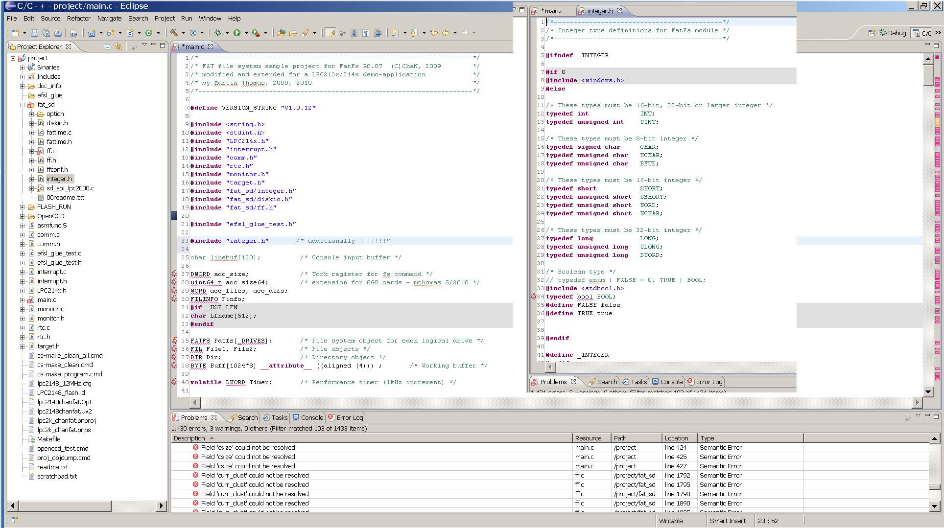

I recently switched from Eclipse Ganymed and WINARM to Eclipse Idigo
(Build ID 20120216-1857) and Codesourcery Lite 4.6.1.
To start with these new tools I got a working project and it seems to
be compiled correctly. At least the CONSOLE area tells me "Build finished",
there are no errors messages there and I'm getting an .elf file as the
result.
Nevertheless , I'm also getting hundreds of errors in the PROBLEM area.
The errors are mostly like "Type 'DWORD' could not be resolved" . However, DWORD
for example ,is defined in an include file which is available , included
and NOT marked as unresolved.
I have the impression, after starting Eclipse and after an instantly performed
build process, the errors are not visible. After a while however, suddenly
the errors appear. I never noticed this behavior with Ganymede and WINARM.
I assume it's a problem with Eclipse and not with Codesourcery .
Can anybody advice how to fix it, please ?
(the picture illustrates the issue)
Robert

Re: Compilation successful, but errors anyway [message #884957 is a reply to message #882463] Tue, 12 June 2012 03:06 Go to previous messageGo to next message
This are error markers from the Eclipse code analyzer CODAN. It was activated by default in the Indigo release. CODAN depends on a proper index i.e. your project must be set up to have all includes and preprocesser symbols (see Project Properties->C/C++ General->Paths and Symbols).
Re: Compilation successful, but errors anyway [message #885797 is a reply to message #884957] Wed, 13 June 2012 12:04 Go to previous messageGo to next message
Thanks for this information.
Can I switch CODAN off ?
It confuses me totally.
Thanks a lot
Robert

Re: Compilation successful, but errors anyway [message #886103 is a reply to message #885797] Thu, 14 June 2012 04:49 Go to previous messageGo to next message
Robert Ty wrote on Wed, 13 June 2012 18:04
Thanks a lot
Robert
Yes.
Project Properties->C/C++ General->Code Analysis->Launching
disable both checkboxes
Re: Compilation successful, but errors anyway [message #886234 is a reply to message #886103] Thu, 14 June 2012 09:49 Go to previous message
Great, thank you very much.
All errors have gone Smile !
Robert
