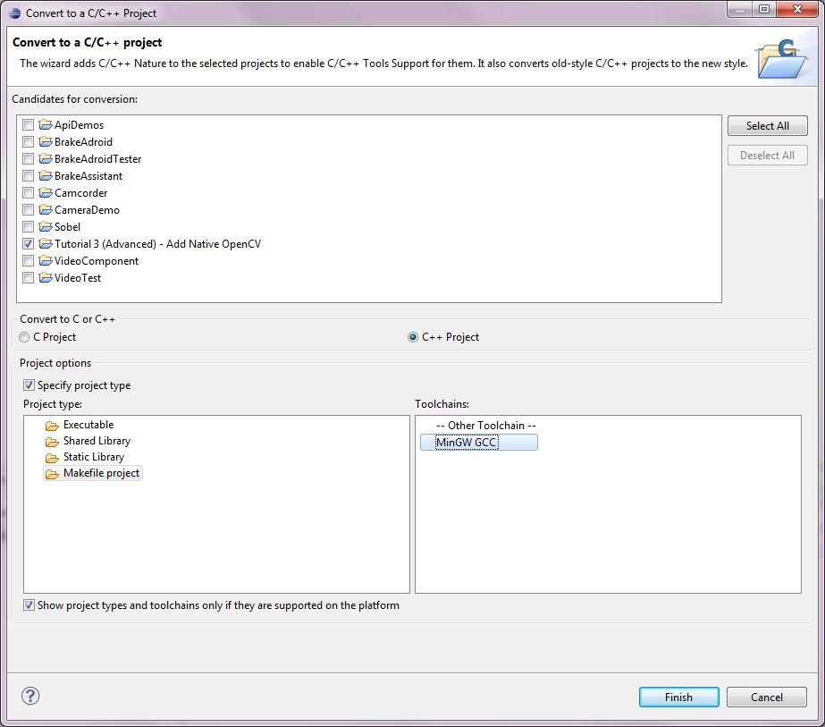

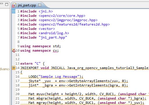

I have a Android project to which a added C++ nature.
But after adding the C++ nature the editor does not recognize the C++ syntax. I tried and its probably set to C syntax.

The same file in a pure CPP project is fine. I attached 2 screenshots to document my doing.
Any help welcome.
Tobias

It does not completely ignore the C++ syntax. It just does not recognize the cv namespace.
Did you rebuild the index (context menu of Project)? Are there unresolved includes (context menu of Project: Index->Show unresolved includes)?
