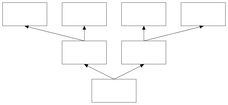

Hello i have a question on customizing behaviour of the "Arrange All" function.
Normally all the nodes in are arranged "Bottom-up" as shown in the picture i appended.
Can i change this to a "Top-Down" Orientation quickly , without writing new layouts etc. ?
I think this is a typical use-case so it would be great if it can be fixed quickly.
Greetings
  • Attachment: default.jpeg
    (Size: 30.45KB, Downloaded 337 times)

Found it!
Add the following extension to plugin.xml (of the generated GMF diagram project).
<extension point="org.eclipse.gmf.runtime.diagram.ui.layoutProviders">
<?gmfgen generated="false"?>
 <layoutProvider class="org.eclipse.gmf.runtime.diagram.ui.providers.TopDownProvider">
  <Priority name="High"></Priority>
 </layoutProvider>
</extension>
