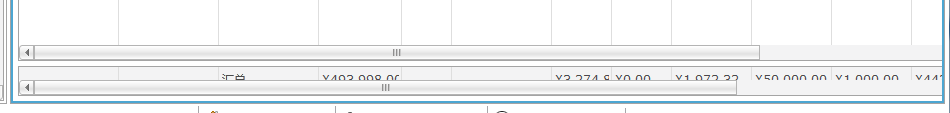

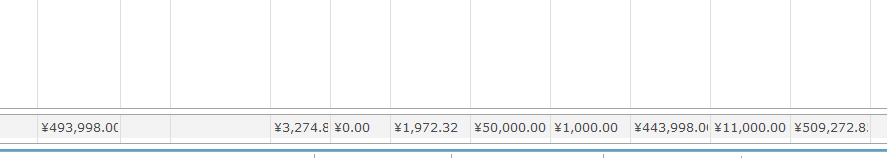

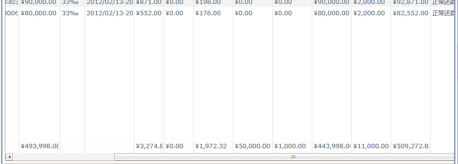

I implemented it with two tables before, but with the container is not big enough, the scrollbar appears like the screen shot image as below:
index.php/fa/7141/0/
How to resolve it?
How to resolve it?

Thanks Ralf, it does work when the tableview has few colulmns, but when we have more columns and the tableviewer scroll bar displays just like below, it looks ill-looking.
few columns:
index.php/fa/7172/0/
but when we have more columns:
index.php/fa/7173/0/
how to do like this even more columns in table?
index.php/fa/7174/0/
David

Now I understand - you're also using the Table widget as a spreadsheet
replacement ;-) I think what you need is a "fixed row" - one that's
always at the Bottom of the Table and that does not scroll vertically.
Such a feature does not yet exist in RAP. FWIW, you'll get fixed
columns in the next milestone!
Would it help to remove the Scrollbar from the Composite that contains
these Labels? They would still appear below the scrollbar but that may
look a bit less broken.
Regards, Ralf

Ralf Sternberg wrote on Fri, 17 February 2012 00:00
Or you could remove the horizontal scroll bars on the table and place the footer labels and the table in their own composite. You can then scroll the composite that contains both the table and the footers as one.
