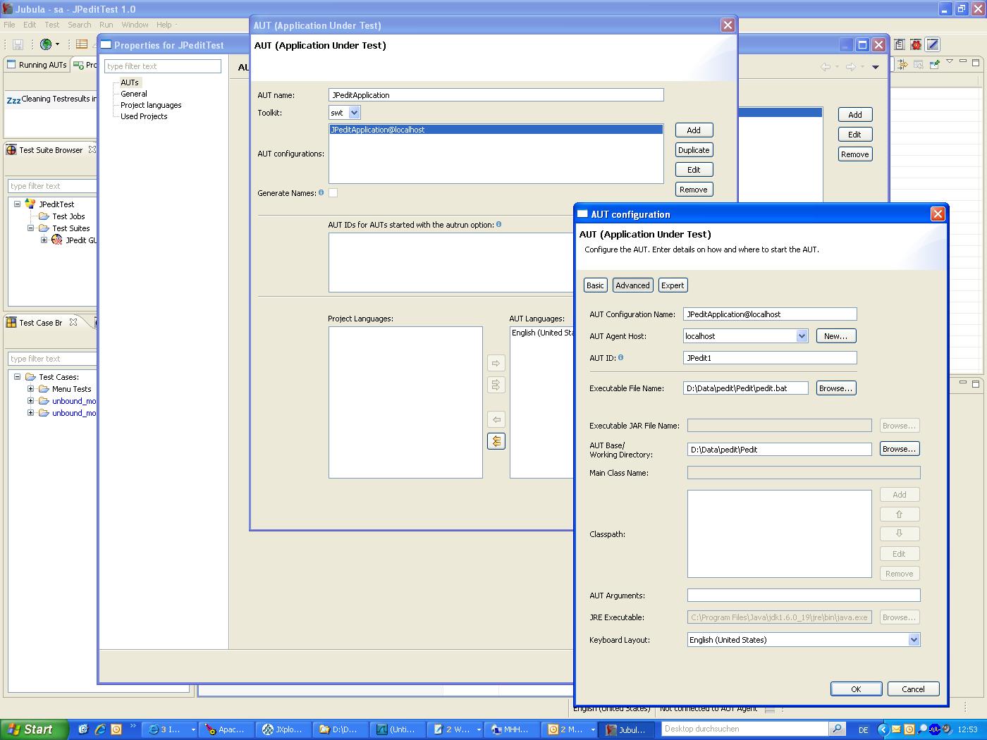

Re: Starting SWT AUT [message #691389 is a reply to message #691061] Fri, 01 July 2011 07:06 Go to previous messageGo to next message
Thanks for all the hints, but it looks like the settings are correct.
Here's a screen shot.
index.php/fa/3210/0/
I also tried specifying the jar itself instead of the batchfile, but same problem.
Maybe I can try to add some logging/debugging to the relevant source files,if you could point me in the right direction?
Stephan

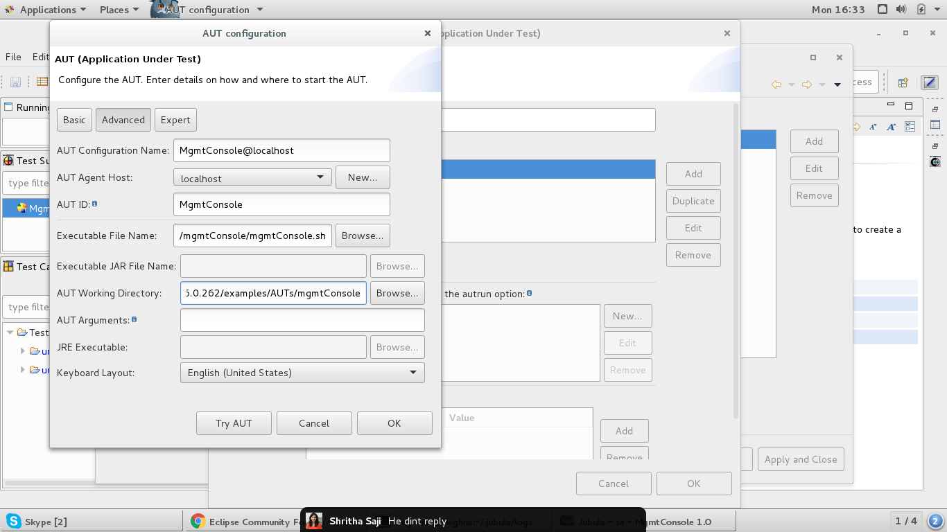

Facing the same issue on CentOS:
AUT is an SWT application
2018-09-17 15:53:29.830 [Worker-8] WARN o.e.j.client.core.ClientTestImpl - connecting the AUT Agent failed

Re: Starting SWT AUT [message #1795399 is a reply to message #1795157] Fri, 21 September 2018 07:15 Go to previous messageGo to next message
Hello Meghana Iyer,
is the shell file working without Jubula?
is the Application which should be tested the first java application in the shell script?
Are you sure your Application is SWT. I assume this because a basic SWT listener is not found. Maybe it is an RCP application with SWT in it or something similar.
best regards
Marvin
Re: Starting SWT AUT [message #1795491 is a reply to message #1795399] Mon, 24 September 2018 05:47 Go to previous messageGo to next message
Thanks Marvin,
Yes the shell file works fine without jubula
Will need more information about the application from the development team here.
