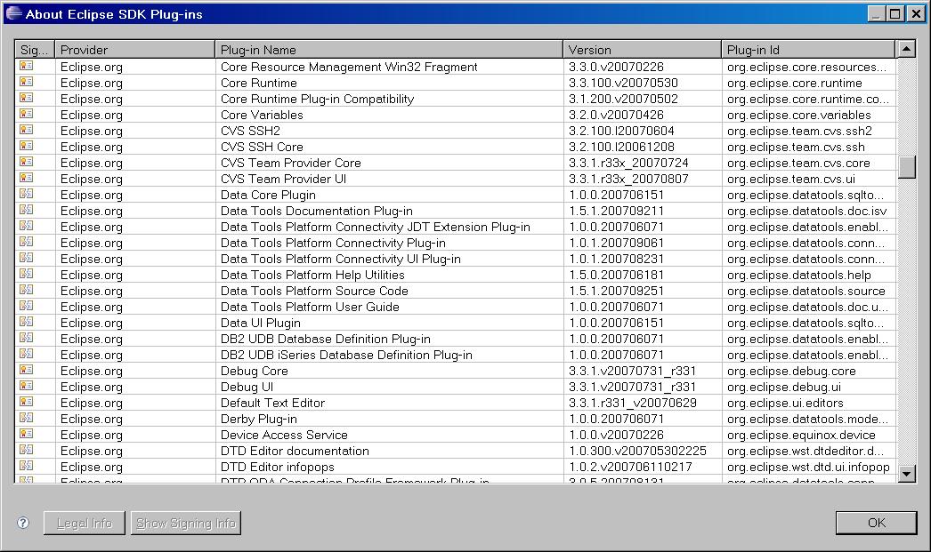

Hi, All-
I'm new to DTP, and I've set up some sample Flat and JDBC ODA connections,
which all ping fine. But the SQL Editor won't allow me to select any ODA
connection to use for running an ad hoc query.
I've reviewed all the "intro" docs I can find relating to DTP, and I can't
find any info one way or the other concerning whether this should be
possible, or if not, then why.
I'm running Europa (3.3.1.1) on XP pro. Attaching a screecap of my plug-in
versions. Would someone kindly advise this newbie?
Elliott Wade
  • Attachment: dtpvers.JPG
    (Size: 185.59KB, Downloaded 319 times)

Elliott,
The SQL Editor is, as implied by its name, specific for relational databases
and SQL statements. Thus it consumes the Database (JDBC) connection profile
type only (i.e. those listed under the "Databases" category folder in the
Data Source Explorer view) .
The ODA framework is for heterogenous data sources, which are not
necessarily SQL-based.
BIRT (www.eclipse.org/birt) on the other hand is an ODA consumer
application, and thus supports any DTP ODA provider. We are adding
integration in Ganymede (DTP 1.6) to allow an ODA consumer application to
consume the "Databases" connection profile type as well.
Linda
