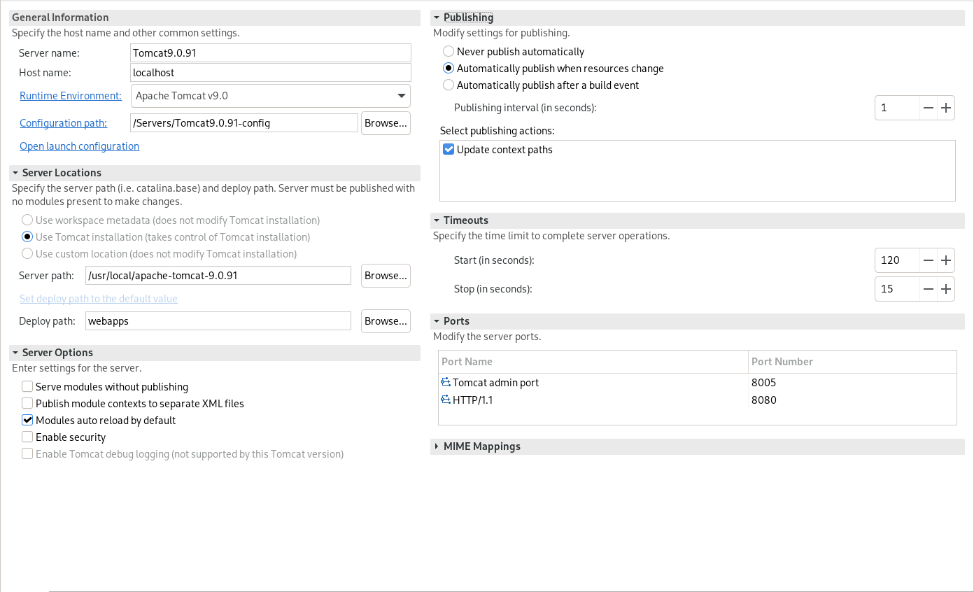

I had hot deploy working for a couple of weeks and all of sudden it will not work. I run the tomcat server in debug mode, state is in debugging, Synchronized. Yet when I change code in JAVA and save it, tomcat says Debugging, Restart. I can't figure why this would be happen. I don't believe I have changed anything that could case this.

That's not really anything to go on. Are the code changes you're making changing method signatures or modifying fields?

I was modifying a line of code similar to
var = "<div>title</div>";
to
var= "<div class="fakestyle;">title</div>";
Even adding a comment requires a restart.
ya I know html in a method, bad but this is an existing program , not much I can do about it.
This did not happen a week ago. I've attached a copy of my tomcat settings.
  • Attachment: Shot1.png
    (Size: 118.58KB, Downloaded 68 times)
Re: Hot deploy stopped working [message #1871094 is a reply to message #1871016] Sun, 15 September 2024 14:10 Go to previous message
Well that's a bit confusing, then. Changing content within a web page that doesn't execute server-side code isn't the sort of thing I'd expect to cause the server
to restart. That's not a JAVA code change as you originally indicated, though.
