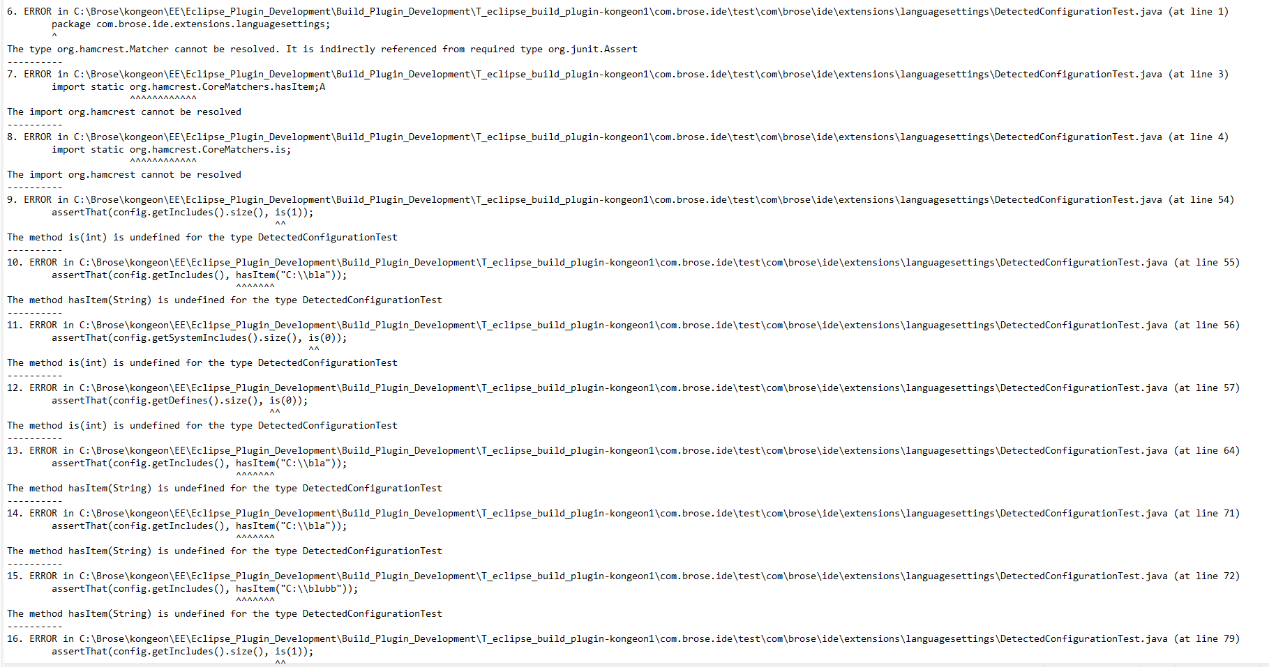

We are encountering an issue with an in-house plugin developed for our organization using Eclipse Committers 4.32.0. After cloning the Eclipse Build Plugin project and updating some of the plugins and their versions, we are facing an error when attempting to export the ZIP file of the developed plugin.
The primary error is: "The type org.hamcrest.Matcher cannot be resolved. It is indirectly referenced from required type org.junit.Assert." Already added the hamcrest-all-1.3.jar and org.junit_4.13.2.jar. as external jars. I have attached a screenshot of the error for reference.

Re: Error while developing in house plugin with the help of Eclipse Commiters. [message #1870770 is a reply to message #1870767] Mon, 09 September 2024 03:34 Go to previous messageGo to next message
The PDE support for exporting to a zip is not well tested and not well supported. Better to bite the bullet and use Tycho to build an update site.
