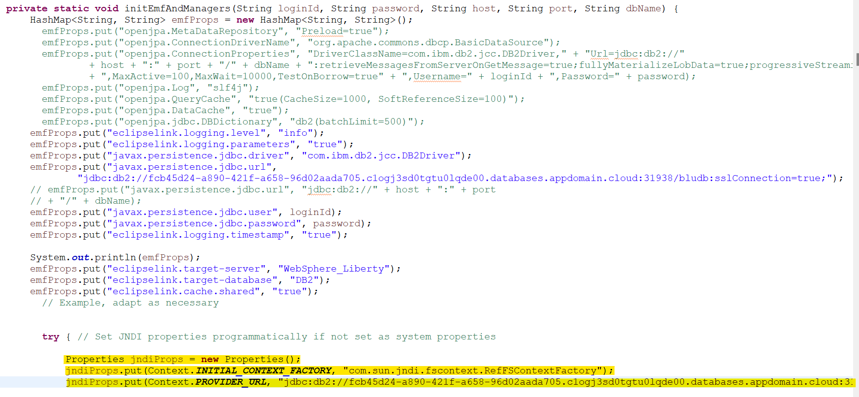

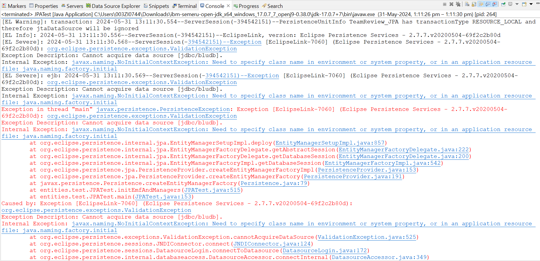

I am getting the following error while trying to run a standalone JPATest.java file.
Here, I am trying to establish the jdbc connection which I am failed to do so because of the following errors.
The initial error said there's no InitialContextFactory [ss: Error1]. Hence, I set it up manually like in the attached ss [ss: JPATest].
But when I set the context factory, I also was supposed to give the provider_url which is not being taken by the context factory I set. It is showing the following error in this place.

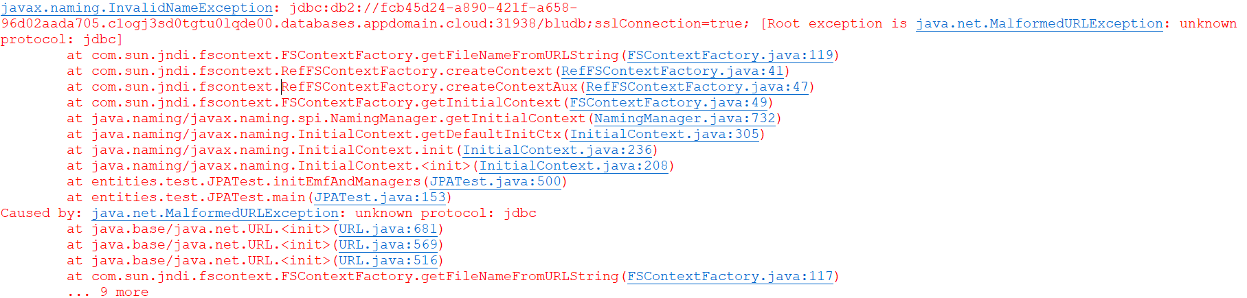

Error: javax.naming.InvalidNameException: jdbc:db2://fcb45d24-a890-421f-a658-96d02aada705.c1ogj3sd0tgtu0lqde00.databases.appdomain.cloud:31938/bludb;sslConnection=true; [Root exception is java.net.MalformedURLException: unknown protocol: jdbc]
Please refer to ss: urlError for the full error message.

I have attached the entire logs as well [ss: Logs].

This issue doesn't have to do with EclipseLink/JPA but with your context configuration, which doesn't seem to be needed - you aren't even showing where you initialize the context with these properties (line 500 in your code) or why you need to do so. As for the config itself: why are you passing in what appears to be a Database URL as a context provider to the RefFSContextFactory class?
