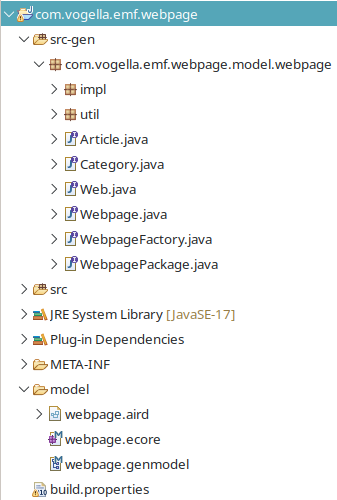

Hey,
I noticed some unexpected behavior in the Model Explorer with the generated code from a .genmodel in an ECore Modeling Project.
In below screenshot, you can see that the src-gen folder does not properly display the files as expected. It rather displays them in a text only mode.
index.php/fa/44146/0/
However, you can make it display text and icons by removing the Modeling Nature from the project natures.

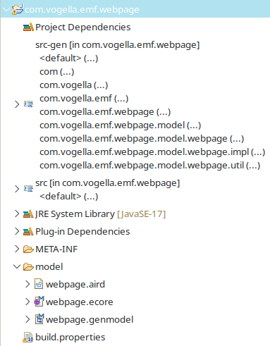

index.php/fa/44147/0/

Re: UI Issue with using Modeling Nature [message #1864886 is a reply to message #1864874] Thu, 18 April 2024 09:58 Go to previous messageGo to next message
Probably you should ask here:
https://github.com/eclipse-sirius/sirius-desktop/discussions
It's also possible that it's an Ecore Tools issue:
https://github.com/eclipse-ecoretools/ecoretools/issues
Re: UI Issue with using Modeling Nature [message #1865697 is a reply to message #1864886] Thu, 09 May 2024 04:44 Go to previous message
While the Modeling nature/perspective was well-intentioned, its implementation is sadly deficient. The Model Explorer view that 'replaces' the Package Explorer View familiar to Java users unfortunately replaces rather than extends. Consequently many behaviors differ in ways that confuse Java users. e.g a number of menu entries are missing and some additional ones are very expensive.
Yes. I have seen similar issues, resolved them and reported them. Bottom line, never use the Sirius/Modeling perspective if you can possibly avoid it. (I am working on a regular Initialize Diagram action accessible from the Package Explorer View so that creating a diagram is as easy as it was in the pre-Sirius Ecore Tools days.)
