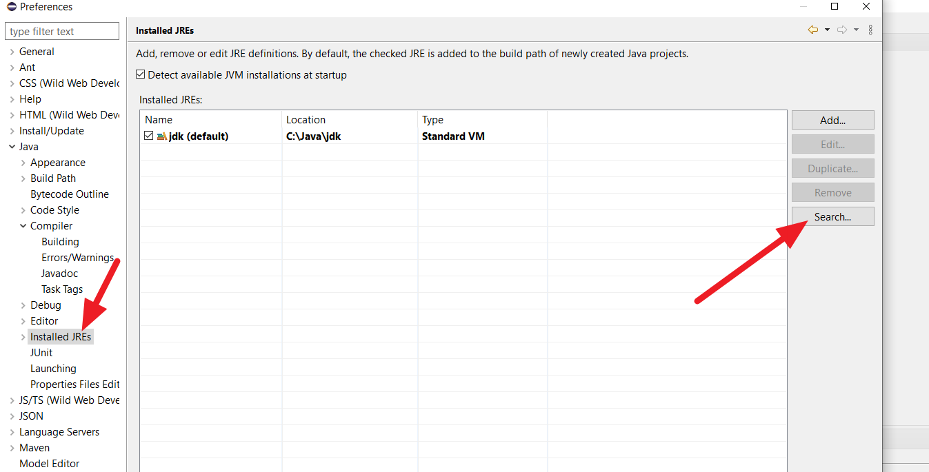

You can add other JDKs using this:
index.php/fa/43982/0/
You might have multiple JDK on the system, and you can select the one you want for your project.
