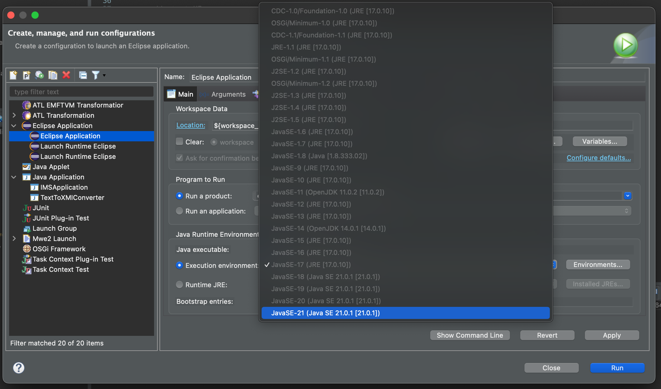

Thank you Christian for your reply! Indeed my run configurations for Eclipse application had this problematic JDK 17.0.10 as well. It turned out to work after I changed it to 21.0.1.
index.php/fa/43963/0/
Interestingly when creating an Xtext project it defaults to JDK 17, but for other EMF projects I had before, the run configurations were automatically set to JDK 21 (which is the default in my system) so they didn't have this trouble before.

Re: Rendering problem (?) in runtime Eclipse application [message #1863486 is a reply to message #1863478] Mon, 05 February 2024 02:14 Go to previous messageGo to next message
if you have xtend files in project the compilation against target 21 wont work. this is why default is java 17
Re: Rendering problem (?) in runtime Eclipse application [message #1863487 is a reply to message #1863486] Mon, 05 February 2024 02:33 Go to previous message
I see. So I will still stick to JDK 17. It also seems to work if I use other sub-versions other than 17.0.10.
