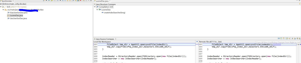

I have two local branches (e.g. kei_dev, master), My work in kei_dev, now I switch my local branch from kei_dev to master. then how to copy my change from local branch kei_dev to master
1) selectively for each different
I find below screen, is this correct?

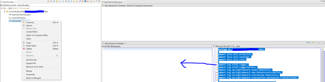

2) whole file copy
I find below screen, but no menu for copy all change from local branch kei_dev to local master current workspace (not commit, just copy to my local workspace)

Re: how to compare two LOCAL branch and then copy the content from one branch to another [message #1863467 is a reply to message #1863413] Sat, 03 February 2024 06:53 Go to previous message
The git way to integrate changes from one branch to another one is
- merge if you want to ensure all changes are integrated
- cherry-pick to copy individual commits.
