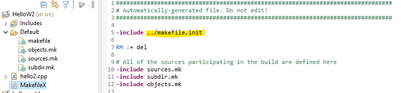

The first few lines of the makefile are:
# Automatically-generated file. Do not edit!
-include ../makefile.init
<(line 6) blank
RM := del
# All of the sources participating in the build are defined here
-include sources.mk
-include subdir.mk
-include objects.mk
-------------------------------- ooo
Any idea what is causing this?
Note there is no ../makefile.init that I can see. see make1.
I make a fake ../makefile.init , same error.

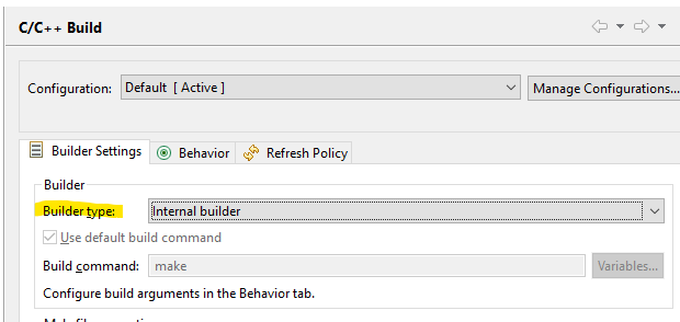

After trying random changes to the C/C++ Build page. I found changing the build type ( make2) from External to Internal( make3), I get a workable make file.
( C/C++ Build : Project Properties -> C/C++ Build )
