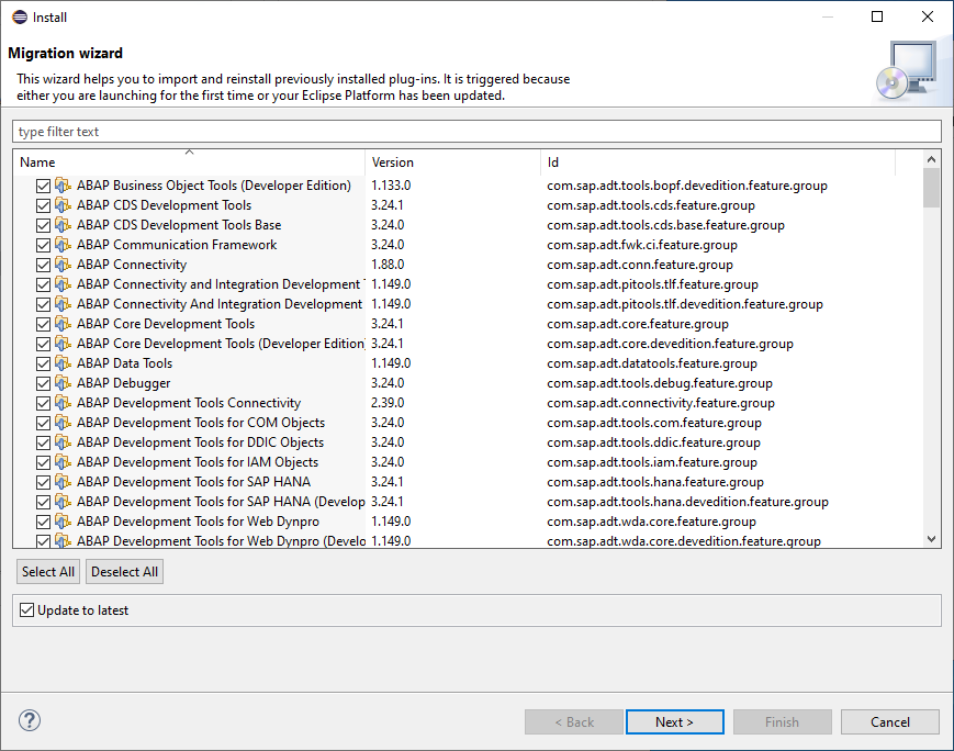

I'm trying to update Eclipse from 2021-12 to 2023-03.
This Eclipse installation is part of a software package that is deployed to developers company-wide. It includes several plug-ins, most notably ABAP Development Tools from SAP.
In the current installation (2021-12), the plug-ins reside in the Eclipse installation path (in C:\Program Files\...) under the "plugins" folder.
This way, they are shared and it is ensured that all developers use the same plugin versions and don't have to worry about installing them manually.
Workspace settings etc. are still stored per-user under "%localappdata%/.../workspaces/<workspace_name>".
The problem I'm now facing during updating to 2023-03 is the following:
If Eclipse notices that there is already a workspace (from the previous install and usage), it will launch the migration wizard.
The wizard takes over the preferences and projects. But, it does not recognize any plugin from the shared plugin folder and thinks that it has to re-install every plugin, see screenshot attached.
Even if the users try to execute the update, it will fail because of some missing dependencies. Anyway, we don't want the user to run the update manually.
Cancelling the wizard is possible, but Eclipse will only work correctly when restarting it after closing the wizard. Unfortunately, this will be too confusing for the users...
How can I provide a smooth migration for this update and for the future with these points?

This is a very complex question where it's not entirely clear to be why you get this behavior nor do I have significant experience with maintaining a read-only shared installation. It will be a challenge to find anyone with significant expertise to answer such a question.
Looking at the code, it boils down to org.eclipse.equinox.internal.p2.ui.sdk.scheduler.migration.MigrationSupport.findUnitstoMigrate(IProfile, IProfile) finding a non-empty set of installable units. None of this depends on there being a previous workspace. For a read-only installation, p2 creates a surrogate installation in the <home>/.eclipse folder the first time the user runs that application. This creates a profile in that surrogate that's essentially a copy of that in the shared installation's profile. If you change the shared installation, the migration support will compare the old profile with the new/current profile. You can block this with -eclipse.p2.skipMigrationWizard=true in the eclipse.ini of the shared installation; I don't know what bad impact that will have. You mentioned a restart is needed and that's probably not going to happen if you block the checking.
I wonder if the wizard is presenting all installable units or just the ABAP ones. I can't tell from a picture showing alphabetically sorted IUs. My sense is that findUnitstoMigrate should remove from the set any IU that is simply being updated to a new version so that makes me wonder how the ABAP IUs have been installed into the shared installation?

Thanks for the reply, Ed.
The Wizard shows all units, not just the ABAP ones.
They have been installed this way:
I had set up a fresh install of the Eclipse Platform, started it and installed all additional packages (ABAP for example) through the Install Software dialogue. Then I copied the plugins from the user-specific folder under %localappdata% to the plugins folder in the Eclipse installation path, so that they can be delivered to all users that request the whole Eclipse installation.
Maybe there is a better way?
