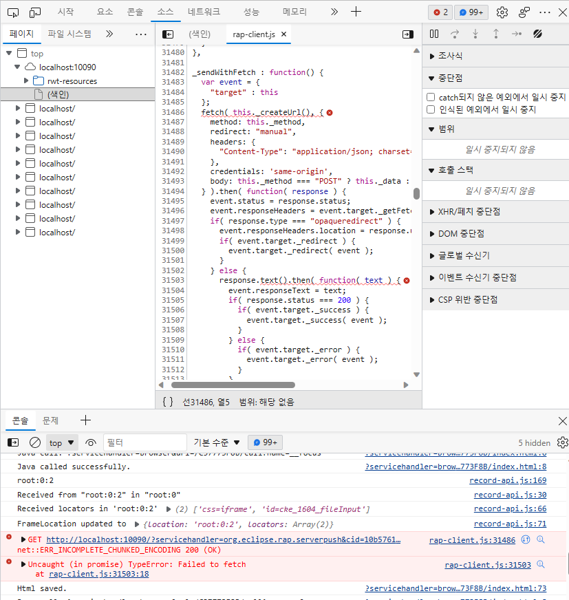

In my Eclipse RAP development environment (Jetty), sometimes the UI hangs up.
In that case, it only works when performing UI activities, such as clicking a button with the mouse.
This will continue until the page is reloaded by clicking the browser reload button.

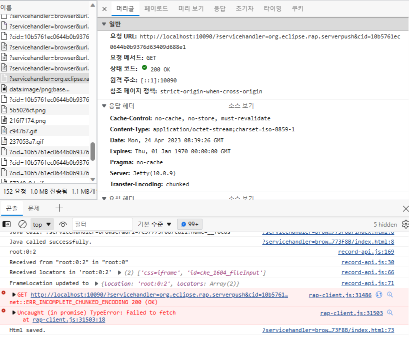

This is the error content confirmed by the browser developer tools.
index.php/fa/43146/0/
index.php/fa/43145/0/
In the above, it seems that the ServerPush response came in an incorrect chunked method, and the error occurred because the RAP Client could not handle it.
I'm curious about something like this:
1. Why is ServerPush's response processed in a chunked way and what to do otherwise?
2. Even if an error occurs in the relevant part of rap-client.js, ServerPush processing should continue. Why was it stopped?
3. I am using RAP version 3.21. Are these issues fixed in later versions?

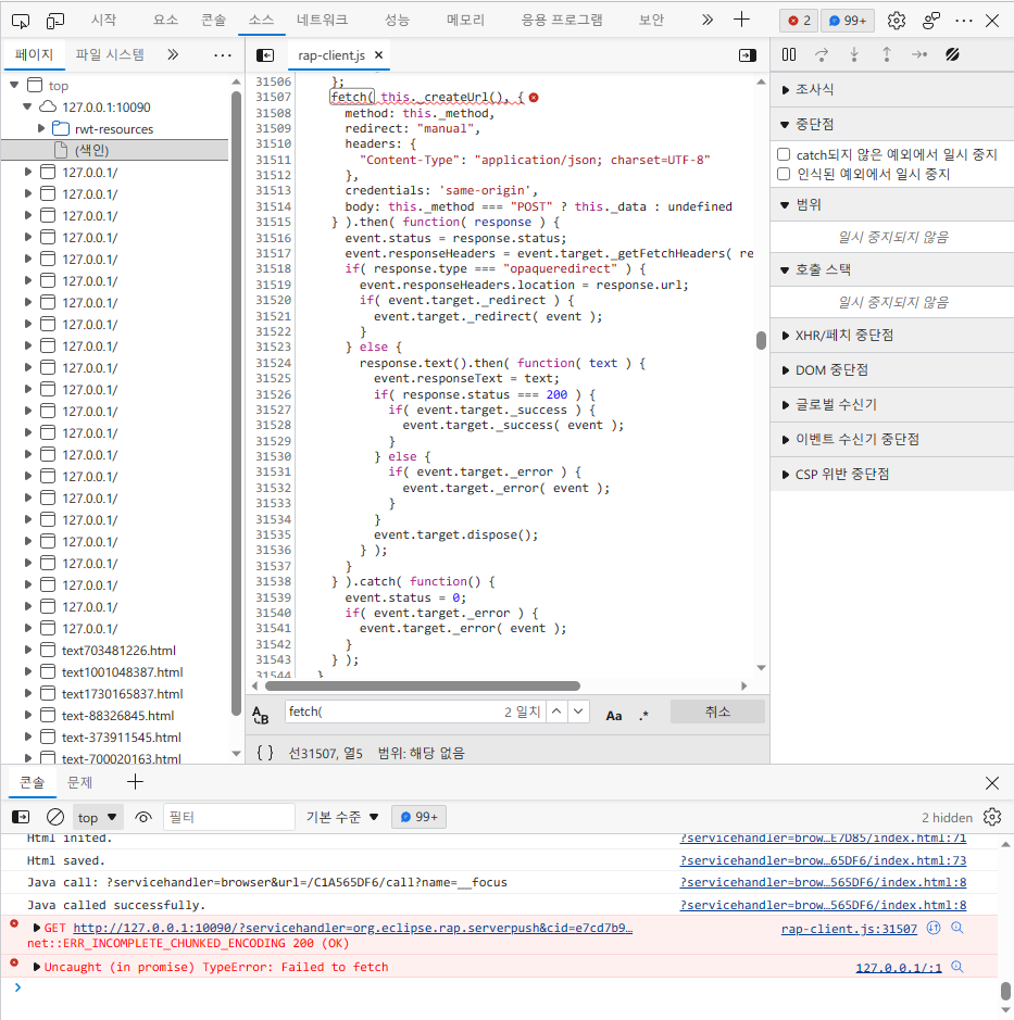

Thank you for replying in advance.
After upgrading to RAP version 3.24 and testing, the same phenomenon occurred.
By checking that the rap-client.js file was changed, I expected the phenomenon to disappear, but it did not.
The line where the error occurred was 31486 in RAP 3.21, but it is 31507 in 3.24.
index.php/fa/43154/0/
Will the error disappear if I upgrade to RAP 3.25 version? RAP 3.25 version has not been officially released yet, so I upgraded to RAP 3.24 version.
