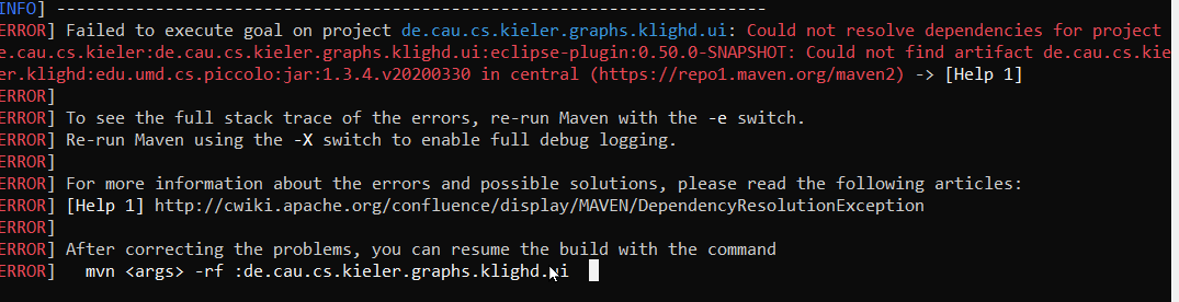

As part of my project I would like to use the GmlImporter in the Kieler project to read in Gml graphs to process with Elk. I cloned "pragmatics", but when I perform mvn install in a Windows command window, I get an error message as shown in the attached file. The script attempts to install "edu.umd.cs.piccolo:jar:1.3.4.v202003330". I can find no reference to this jar in the "pragmatics" folder. I can find no reference to it online. Can you provide guidance about how to complete this install? Thank you.

We usually use an Oomph setup to install everything. Sadly this no longer exists only for the pragmatics but only for a pragmatics + semantics combination on the "Keith" stream in the semantics setup.
You can find the desired jar here as part of the klighd nightly update side.

I took an easier path, went to the pom file pragmatics/plugins.pom.xml and commented out the appropriate lines. That worked for me.
Thanks for the pointer though if I need that jar.
