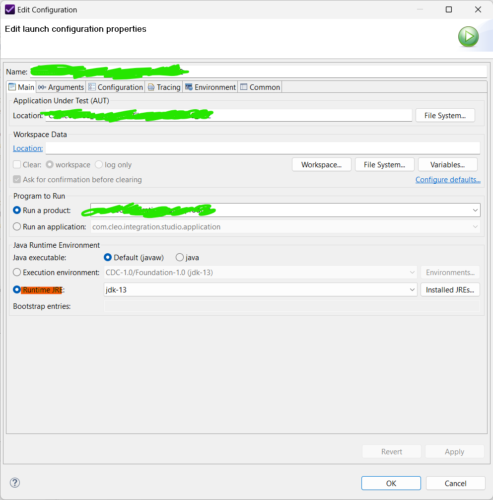

You can try changing the JRE in the Advanced configuration of the AUT.
Or pass as the VM argument to a lower java version :
-autVM "C:\jre"
