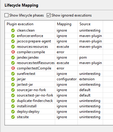

After selecting all projects and running Maven -> Update Project I got this error:
Description	Resource	Path	Location	Type CoreException: Could not get the value for parameter compilerId for plugin execution default-compile: PluginResolutionException: Plugin org.apache.maven.plugins:maven-compiler-plugin:3.8.1 or one of its dependencies could not be resolved: org.eclipse.platform:org.eclipse.osgi:jar:3.18.100-SNAPSHOT was not found in https://repo.eclipse.org/content/groups/snapshots/ during a previous attempt. This failure was cached in the local repository and resolution is not reattempted until the update interval of eclipse.snapshot has elapsed or updates are forced	pom.xml	/mxproject.server	line 9	Maven Project Build Lifecycle Mapping Problem

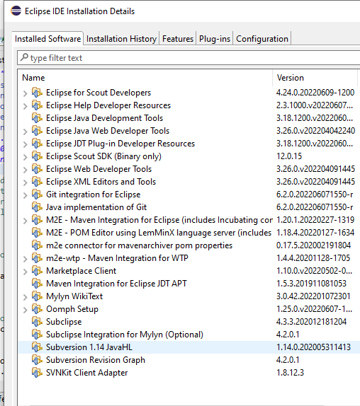

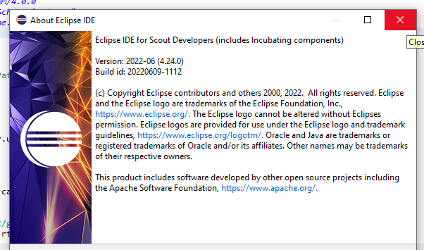

I have uploaded some images (Eclipse Version, Installed Plugins, Maven Lifecycle with errors).
