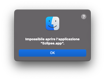

Hi all, I am writing to ask you for some solution to a problem with Eclipse version for MacOS Apple Silicon. Every time I restart my Mac it happens that when I open Eclipse the message appears:
"Unable to open Eclipse.app". This is very strange. I solve the problem each time by reinstalling the application but this is really very inconvenient. Do you happen to have any idea how to solve this problem?

Actually this problem happens often but not always. For example, I reinstalled Eclipse yesterday but today when I turned on my Mac it did not give me this problem. It happens sometimes and I don't understand why honestly.
