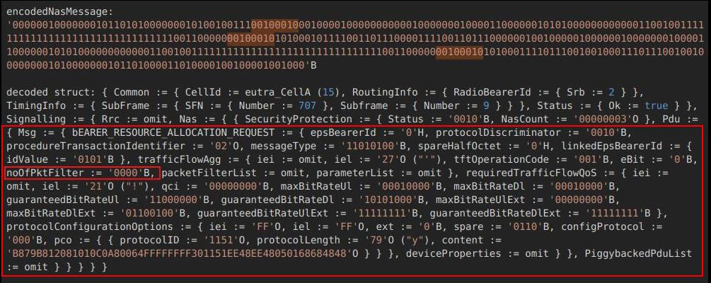

as the struct in the images
what I do is use noOfPktFillter represent the count of packetFilterList elements,
But whatever I do, the decoded struct show noOfPktFillter := '0000'B, while in the encodedNasMessage, which should be '0010'B
do I has a wrong usage of LENGTHTO and UNIT(elements)?

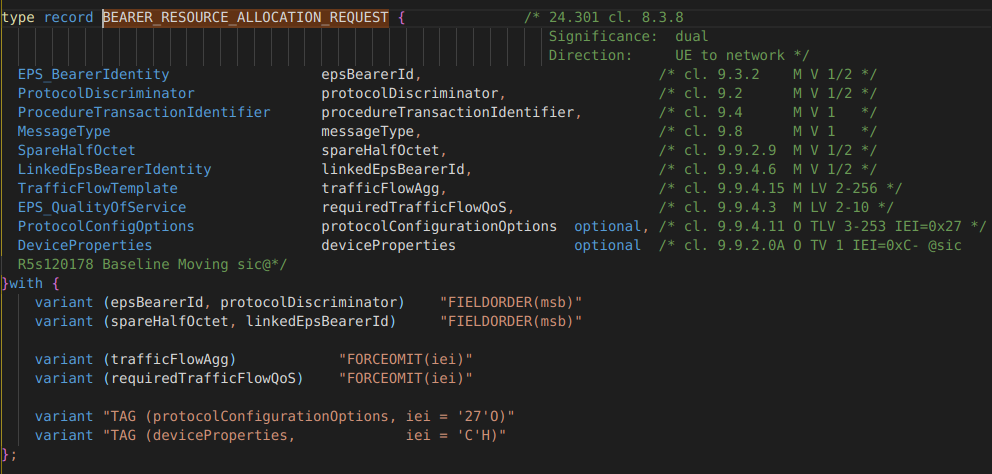

The order of the fields are wrong, Either change the order of the fields in the type definition or apply the FIELDORDER variant.
By default the RAW encoder puts the fields into the octet right to left direction.

The LENGTHTO and the UNIT can't effect the decoding of the noOfPktFilter field only the packetFilterList. Are the value of the tftOperationCode and eBit correct?
Please change the order of the fields in the type definition.
The FIELDORDER attribute is not transitive, practically it effects only the basic types.

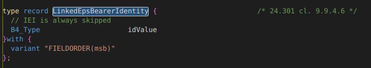

If the LinkedEpsBearerId is not "type bit4 LinkedEpsBearerId" it won't be encoded/decoded as you think.
Re: usage of LENGTHTO and UNIT(elements) [message #1853091 is a reply to message #1853089] Fri, 17 June 2022 05:17 Go to previous messageGo to next message
it still puzzles me
let me show the difference
if I configure as
type record TrafficFlowTemplate{
    IEI8_Type        iei    optional,
    Type4Length_Type    iel,
    B3_Type        tftOperationCode,
    B1_Type         eBit,
    B4_Type        noOfPktFilter,
    record of PacketFilter    packetFilterList    optional,
    record of TftParameter    parameterList    optional,
}with{
    variant    (iel)    "LENGTHTO(tftOperationCode, eBit, noOfPktFilter,  packetFilterList, parameterList)"
    variant    (tftOperationCode, eBit, noOfPktFilter)    "FIELDORDER(msb)"
    variant    (parameterList)    "PRESENCE(eBit = '1'B)
    variant (noOfPktFilter)    "LENGTHTO(packetFilterList)"
    variant (noOfpktFilter)    "UNIT(elements)"

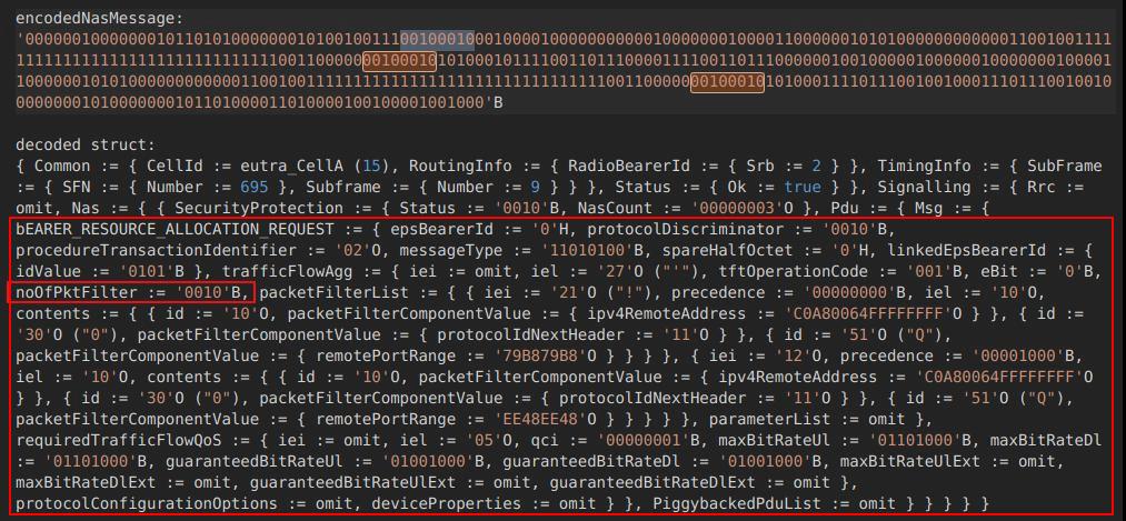

if I configure as
    B1_Type         eBit,
}with{
    // variant (noOfPktFilter)    "LENGTHTO(packetFilterList)"
    // variant (noOfpktFilter)    "UNIT(elements)"

you can ignore the decoding of the previous part (outside the red frame), and the LinkedEpsBearerId is 4 bit
and I cannot change the order of the fields, This is explicit in the protocol documentation

Re: usage of LENGTHTO and UNIT(elements) [message #1853092 is a reply to message #1853091] Fri, 17 June 2022 06:27 Go to previous messageGo to next message
The handling of the bitstring as length field is broken.
Please change the type of the length field to integer.
Re: usage of LENGTHTO and UNIT(elements) [message #1853132 is a reply to message #1853092] Sun, 19 June 2022 23:38 Go to previous messageGo to next message
thank you very much
I solved the problem by changing the type of the length field to integer
Re: usage of LENGTHTO and UNIT(elements) [message #1853160 is a reply to message #1853132] Tue, 21 June 2022 03:13 Go to previous message
The correction has been merged into the TITAN repository.
