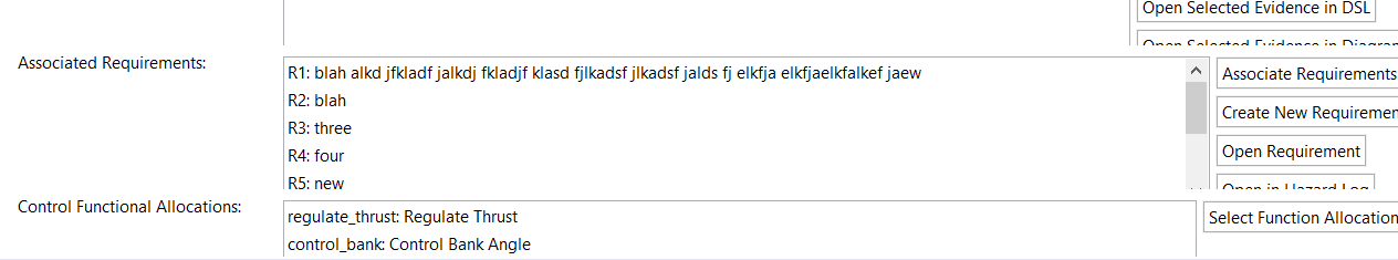

We have implemented several custom widgets for the properties. We ran into a problem where if (on Windows at least) the user sets their display settings to be 125% or 150% scaling, the custom widgets are not given enough room in the properties panel and they overlap each other. (it works fine at 175% scaling)

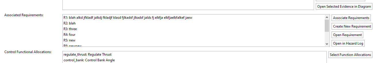

The attached image 100pScaling is how it looks at 100% scaling, and it is fine.

The attached image 125pScaling is how it looks at 125% scaling, and you can see that the widgets overlap each other and are not fully displayed.

Is there a way we can implement something on our end to correct this, or should I submit a bug report?
